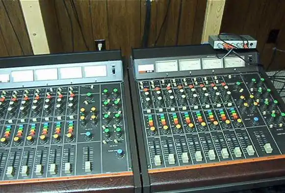

Got the mixer today and first thing started to clean the funk off of it.
Besides that it was to cold from being in the delivery truck all day to plug it in. Took about 1.5 hours to clean the writing off. most of it came off with 91% alcohol, had to scrub pretty hard though. I took all of the knobs off and let them soak in hot soapy water while I working on it. I found out that the m30 faceplate comes off with just the 4 screws on top and one hex nut on one of the pots. So cleaning the face plate was simple. Being able to take it off that way all I had to do was take it to the kitchen sink and wash it with dish soap.
There is just a little shadow of the writing left on the top that I just cant get off but you have to look at just at just the right angle to see it in a bright light. The front cleaned up with no problem though.
So the big suprise was when it was all cleaned up and I plugged it in and all the meter lights worked that was a good sign. Then hooked it up to the 22-4 and bam we had audio on everything. So it turned out to be a pretty good deal. I would give the mixer about a 8.5 out of 10 cause of the scratches you can see in the photos up near the far right monitor meter.
But oh well cant expect to much out of a 25 year old mixer I guess. ;)

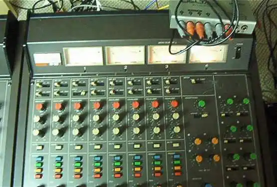

And one of the twins
Oh and one thing I learned about taking knobs off. The bottom part of the sweep and pan knobs can be hard to get off sometimes. If you just turn it all the way in one direction and put just alittle pressure on it, It will click just a little and loosen up so that it will slide right off.
