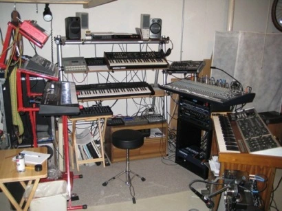

why not just get a cheap Behringer mixer. The Xenyx series mixers have all the stuff you want and you can get a 12 channel for, like, 100 bucks. I record with a lot of instruments, so I'm currently using an MX3482A that I bought off of Craigs list for $350.00. I just run the main outs to the multitrack (Tascam DP02CD) ins and I'm good to go. I'm also using a lot of external effects that I run through the board.
