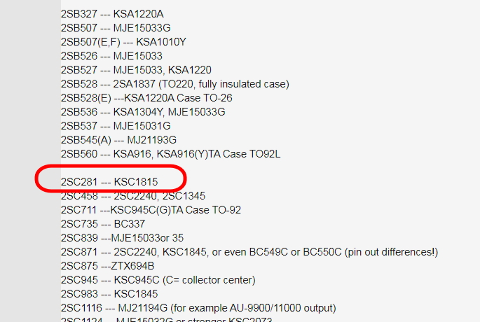

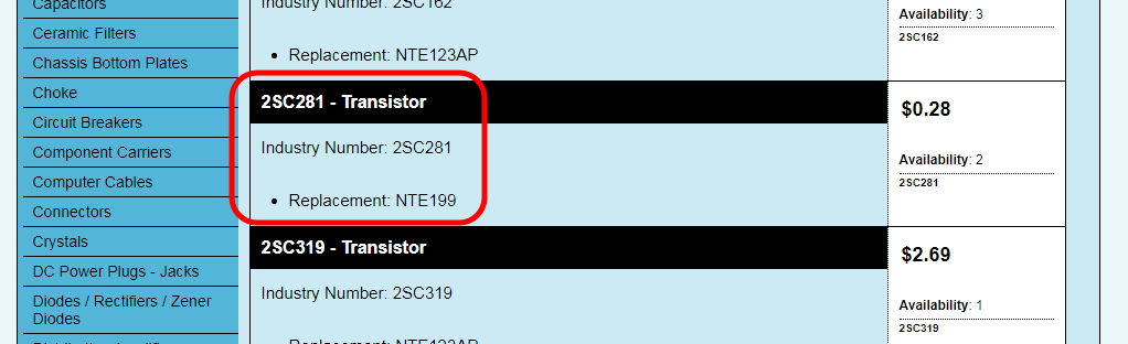

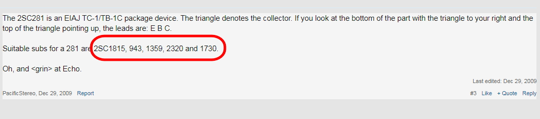

So I'm restoring an Akai X-150D reel to reel machine, and I'm looking for some replacements for some obsolete transistors:
Hitachi 2SC281.
I have found some originals on eBay, but the prices are very inflated ($10 or more for 1, etc.) compared to modern ones you'd get from Mouser, etc.
The problem isn't that I'm not able to find a replacement listed; it's that I'm finding too many listed. In three different sites, I've seen three different suggestions and have yet to see the same one repeated. (See attached.)
I'm wondering if anyone can help me sort out which one to trust (and maybe a little of the why)?
Thanks!

That transistor is nothing special. In fact it is probably just a generic, Silicon planar traisitor, one of billions made and put in cans or plastic cases and stamped with the desired name an number.
You could use BC109,BC108, BC184L or one of score of other types numbers.
Why? The important parameters are,
VCE0 the operating voltage. That one is 30V I bet the circuit is 24V? So safe.
Ic max the current capability. 100mA, most small signal circuits work at 1 to 5mA WELL safe!
Hfe/Beta. Sort of current 'gain'. can never be exactly specified for transistors so they give you a range. The circuits therefore are designed so it does not matter.
The transistors in a tape recorder circuits are mostly non critical except maybe such areas as the bias oscillator? (they also VERY rarely fail! Wassup?)
