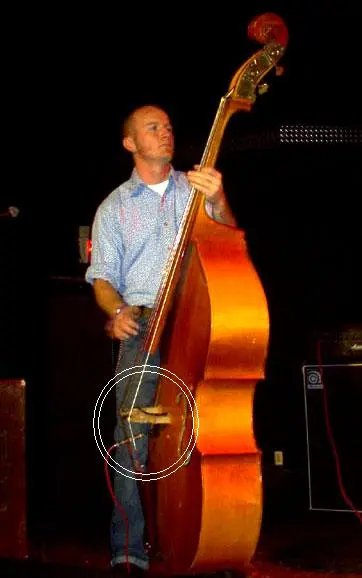

If the room sounds like shit you can try this...
If you have a mic that has an omni pattern wrap it in some foam and place it in between the strings and the the front resting on the bridge.
Old soundguy trick-
Wrap a 57 in something soft with the capsule sticking out, drop it under the tailpiece facing up towards the bridge.
easychair said:
Old soundguy trick-
This is okay for live sound, but for recording it's not good.

easychair said:
Old soundguy trick-
i've done this and it works well! i keep it in the bag for when i need it recording for sure.
i've also used a 451 in the bridge in foam pointing up capsule exposed. fab.

I'll agree that you don't want to try the SM-57 wrapped in foam under the tailpiece... I don't even like this for live sound! A lot of people at festivals I go to use it, but it is way too boomy for my taste...and what looked like a Fishman pickup in one of the pick posted earlier in this post; I've tried those for recording too... I get way too much finger/string noise with those... The bass player in my band uses one of those live, but we've never been able to record with it...
