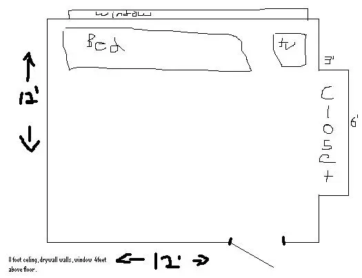

Alright, I've rendered a 3D image of my room with hours of work on photoshop. I'm wondering what would be the best way to treat it acoustically on a budget. I'll be tracking, mixing and mastering in this room. I hope my picture isn't too intense for some of you.

hahaha... yeah it is. Well maybe not the whole photoshop part.
That room is 2 feet wider than the room I use and almost identical otherwise. I had to sacrifice the bed. Now I have a decent small studio, but I have to sleep on the couch.

I'm reading the article that APL linked me to. So to the best of my understanding, rigid fiberglass is the way to go over foam. Also it seems to be cheaper. So If I set up my computer and recording equipment directly across from my closet I would definnately need to deaden the wall behind me. But what about the closet door?... hmm... Also I'm assuming small bass traps in each of my corners near the celing would be a good idea?
If your closet is full of clothes, and you open the doors (or remove them) it will be very absorptive.
Alright, good to know I'm not going to have to throw out my clothes. So basically some bass traps and a few diffusers on the walls are all that I'm going to need?
You will need absorption panels and bass traps to start with (diffusion is different). The more bass traps the better (to try to put it simply).
