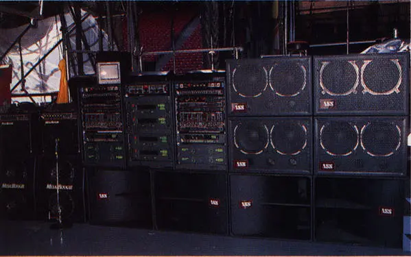

I suppose I should list my rig which gets a lot of good comment from both sound guys and other bass players (especially the ones that want to use it at multiple band shows).
I have an old Gallien Krueger RB800 head, which has 2 amps in it, a 300 watt at 4 ohm and a 100 watt at 8 ohm. There is a crossover that can be switched in.
I use 2 old EV TL 1 x 15" boxes with the EV 15" speakers still in them. I also have a 2 x 10" cab with Lorantz speakers. I plug the 2 TL cabs into the 300 watt amp (which is now running at 4 ohms) and the 2 x 10" cab into the 100 watt amp (running at 8 ohms). I have found that the rig actually sounds better if I bypass the crossover and run all the boxes full range.
There you go a good solid work horse set up 2 x 15s and 2 x 10s and 400 watts of amp. The rest of the sound is in the eq (which I run pretty much flat with the mid notch on the amp selected), that bass plugged into it (1974 fender Precision, 1989 Fender hollow body precision with fretless jazz neck, 1994 MIJ Fender Jazz fretless and sometimes a Ibanez BTB 5 string) and the playing technique.
15" speakers are fine for any gig, the problem is that a lot of players also crank up the bottom end on the amp, keep the amp bottom under control and move the air naturally and the bottom wont be a problem, I do like having a couple of 10s in there also. Not a big fan of 18's, even in PA subs. I should also say that I am actually not that loud on stage, the amp power is good for clean headroom, and having lots of cabs also lets them handle the bottom end without stress.
I do like the rig in the photo I posted but, RIP John Entwistle.
