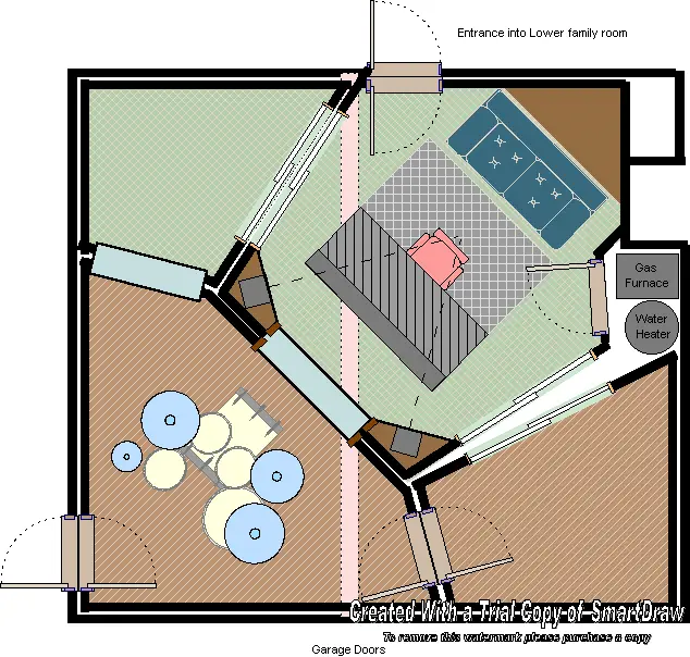

Great stuff folks,
John Sayer DID reply to my request for help. I attached a .gif for you to see. I'm going with his design because:
1) His design is light years ahead of mine
2) Logical layout and use of space
3) Running out of time to get started
Johns awesome, and I appreciate YOUR input about my space. Good luck with your projects; I think I'll go work on mine!
Very nice.
Did you say whether you had vaulted ceilings?
My space does have the open ceiling in one half, I may want to enclose them if I consider something similar. Otherwise the room will definatley not be symmetrical.

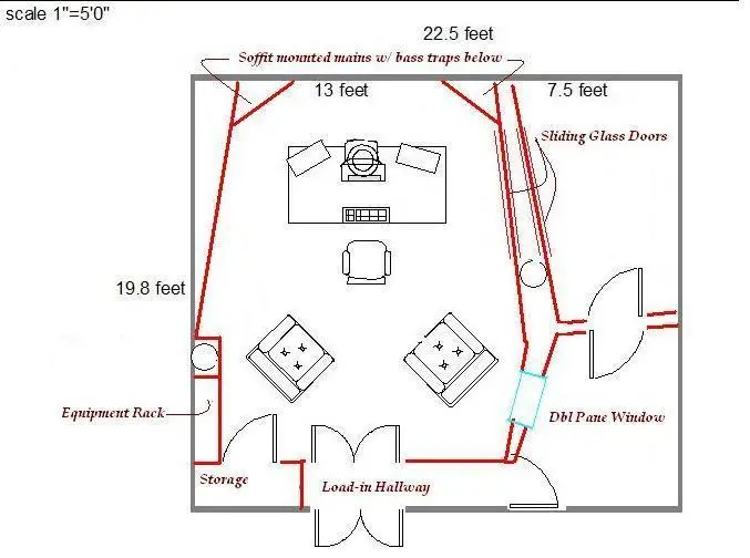

Wayne:
I threw this design together for "Cross Studios" (An hr.c member).
While your dimensions aren't exactly the same as his, they're very similar.
I think it could be adapted well to fit your needs.
Look it over, and if you want something more specific, let me know, and I'll work it out with you.

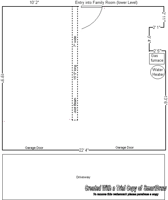

I like your two-iso booth design as well. Thank you so much for the offer to help me. I've attached the skeleton dimensions that I originally sent John (Sayer). I very much like his three iso booth design, but I know it'll be a tight space as well. Your design has a much more open control room look. I can use it as an iso booth as well and monitor in headphones. If you have time and would like to skew the design you posted to my dimensions, I'll name my first grand child after you...

I didn't see John's design. (I gotta start reading the whole post!)
It'd be hard to come up with something better than John's layout, but I'll re-draw the design I did to fit your dimensions if you like.

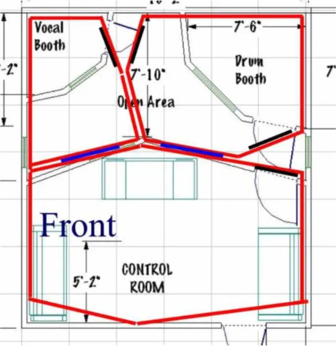

Maestro,
None of us are getting any younger..........it took me 35 yrs to realise the dream of being able to record me and my guitar :) .
OK, I had typed out a lengthy reply and lost it all, so this will be briefer. I have done an overdraw of your design, based on...... 1) it is generally accepted that a control room is better being longer front to back than it's width and the need for symmetry, 2) the need to increase booth sizes. This is only a very basic suggestion and would need considerable refining but it may give you some further food for thought.
The red lines represent walls, the blue are windows and the black are doors. An alternative for access to the vocal booth would be to replace the window from the control room with a door (or pair of), either discarding the doors between the booths or leaving them in place.
A suggested plan of attack..........get your floor plan sorted out, this way you should know of any access points for electricity, plumbing, etc., at the same time give serious consideration to sheeting the inside of the existing structure, walls and roof area using rockwool between the wall studs and sealing any possible cracks that could be a weak point for sound to escape. Plan on building the control room and booths inside AND NOT attached to the existing walls (small boxes inside a big box). If the work to the existing walls is satisfactory, it is possible that you may not have to sheet the outside of the new wall frames, just pack the void with rockwool prior to sheeting the inside, obviously, sheeting both sides will give even better sound isolation.
When working with an existing and limiting structure, there are always going to be compromises between what we would like to do and what it is possible to do. Ultimately, the first priority is always attempting to maintain the integrity of the acoustics.
As I said before, I would seriously suggest posting over at John Sayer forum, as you will get excellent advice from people who have been there and done (or are still doing) that.......it may take time to get a reply but it is usually worth the wait.

First, a few questions:
Q)Have you looked into getting a permit to do this?
A)No, I'm hoping to avoid that process. Since it's a free standing room(s) within a room, the garage could easily be converted back to a regualr garage in the event (God forbid!) that we sell the house.
Q)What sort of power exists in the garage right now? (Locations of all outlets)
A)Outlets are an issue. I only have two one for each of the garage door openers. Someone told me to add a 30 amp separate breaker in my panel box.
Q)Are there any windows?
A)No windows, but PLENTY of leakage. I'll have to plug all those before contruction begins.
Q)Could your existing A/C and heat be modified to heat and cool the new space?
A)I believe I could do that. However, it never gets too cold in the Pacific Northwest. And I won't be heating all iso booths all the time. I've had good success with oil filled raditors. Our family room sits on the same concrete slab in the next room and it heats the space great. Plus, the oil furnace is silent operation. Don't know about the summers yet. I don't know if it'll get warm or not...
Q)Where is the Air handler for the A/C - furnace?
A)No AC in the furnace.
Q)Did you want to go with a separate A/C system for the studio?
A)I don't think so...
Q)Where's the breaker box for the electrical located?
A)Excellent thought. It is in the garage so I need to make sure one of the iso booths has access to it. It's on the opposite wall from the gas furnace (looking at the scheme, its' on the left wall)
Q)What type of garage door is there right now?
A)Two garage doors. They pull up with garage door pulley systems one on each door.
Q)Can you post some pics of the space?
A)My wife and I are currently having a storage shed(yard crap) built in the bacjyard. Then we have to put some of her teaching supplies into a monthly storage facility. Then we haul what's left to the dump. Until then, the pictures wouldn't do any good. I WILL post once the other tasks are completed. I'm shooting for the middle of August..
