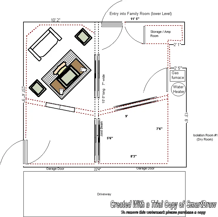

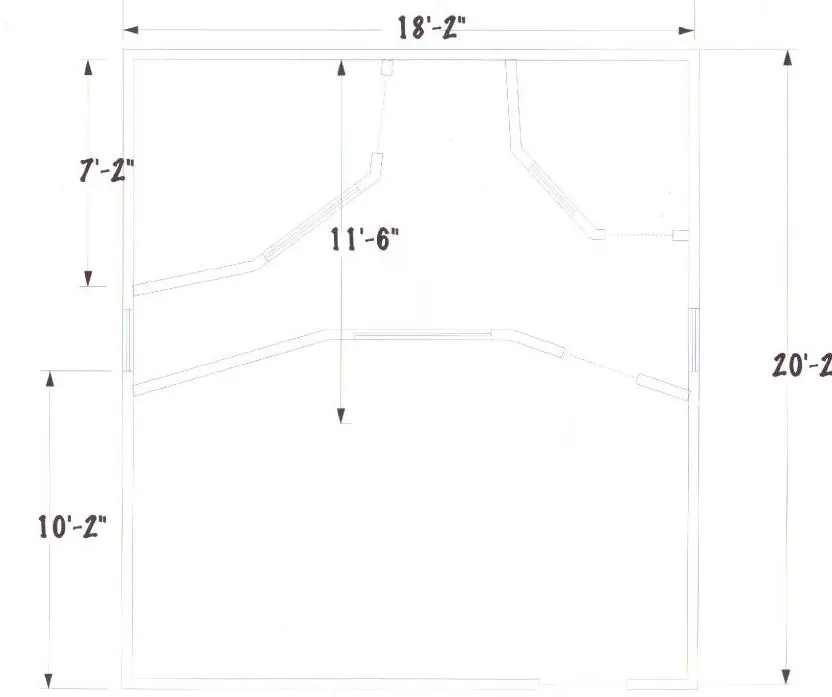

Howdy folks!
I have a 2 car garage that I want convert into a small home recording studio. Small band demos, overdubbing sessions, voiceovers, etc. I have $10,000 and 2 months of free time to get it done. Help me, I'm dumb!
1) Garage is attached to house
2) Cement Floor
3) Ceilings are 8'4" tall
4) Center joist lowers ceiling to 7'5" and is 7 " thick
5) Gas furnace and water heater are in garage
6) Would like a descent control room and a couple of iso booths
if possible.
Look at my virgin smartdraw diagram and let me know what you think. Be kind, I bruise easily!
Sincerely,
~Wayne

I was thinking about the same thing..I have almost the exact same setup as you have. Sitting in my cubical at work is giving me a few ideas for the control room.
Obviously we are both short on space but not as bad as a bedroom and it's square. I think 8 Feet Wide should be fine but i'm also thinking about using one of the corners as the control room to save space.
Any Ideas?

Have you guys checked out the information at http://www.saecollege.de/reference_material/index.html yet? If not, this site provides a great tutorial on studio design with lots of things to consider.
I think there is a 2-car garage plan there that could be adapted quite well to fit your needs.
As far as what you've laid out so far, I would suggest that you be wary of square corners and parallel walls. The control room is a nice size (I'd love to have that much), but there will be problems without doing some work on the acoustics to break up the long parallel walls. You need to setup your console/mixing station on the short wall so your speakers fire down the length of the room. As far as the tracking room goes, your main concern will be breaking up the parallel walls to reduce direct reflections. After that it is a matter of how much you really want to do to get it as perfect as you want it.
Again, read through the SAE site. Also, www.johnlsayers.com is an excellent resource. Go to the forums page and you'll find that it is dedicated to studio design.

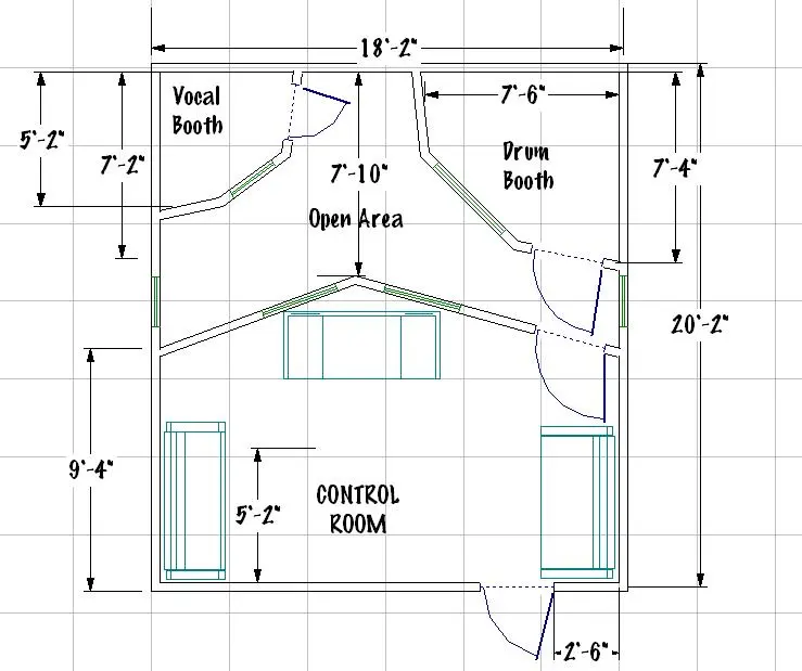

My garage is in the process right now also, and has very similar dimensions to yours Wayne.
I too am debating as to how to lay out the wall design.
I have some friends helping me. We spent the 3 day weekend working on it. Saturday was spent demolishing the old drywall(not insulated underneath) and removing the garage door, then starting on the new outside wall. Monday we finished the framing, plywood skin outside, and new steel door.
Now I am ready to start framing the inside walls, so I want to be really sure I do it right, in a way that will work for me for years to come.
This is one idea, drum iso in upper left corner, vocal iso in upper right, control room bottom with a window facing both booths. The open area in the middle can be used for guitar players or keyboards or whatever is needed. I kind of don't like the "dead space" there in the middle, but I think it will help with the isolation in the control room, especially with the drums.
I also need to decide how thick I need to go on the walls. And how much sound is acceptable leaking in from outside, and vise versa.

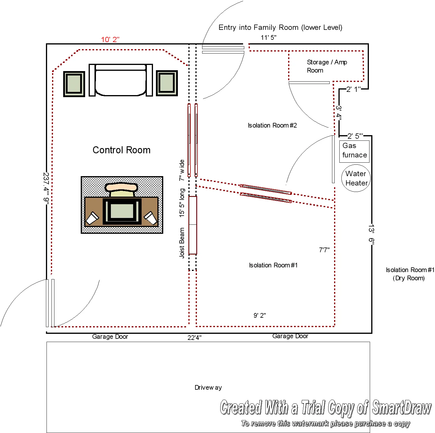

I came up with Plan B. The control room is bigger (could record bass DI, scratch vocals, etc). The room in the upper right (Iso #2) could be a vocal booth, guitar (notice the storage colset in the corner for isolating guitar if needed). The room in the lower right ( iso #1) would be good for drums or whatever.
Let me know what you think. My wife thinks I'm going crazy. Probably right...

A couple of little comments from my point of view.
1. Your control room is basically 10x20 feet. There are potential acoustical problems there with the dimensions being almost exact multiples of each other. It would probably be better (and easier to treat) if the length of the room was cut down to about 16 feet. Old school studio room design used dimensional ratios to determine how the length, width, and height of a room worked together, and I think that the length to width ratio was 1.6:1. Using a ratio like this will help reduce the buildup of standing waves. You will probably still need to do some treatment for the parallel walls but it will be less than the amount needed with the current configuration.
2. The iso booths look okay but you may want to add some splay to a couple of the walls to get rid of the parallelism.
3. I'm not sure I follow your traffic flow. Make sure you can access the rooms easily in normal operations (ie. is there a way to get into the iso booths from the control room without going through the house? Can you go from one iso to the other?
4. The amount of space between the location of your monitors and the wall nearest the driveway seems like a lot of wasted space. I would be inclined to swap the locations of the console and the couch to make better use of the space.
Anyway, that's all my thoughts in random order. It looks like a fun challenge, and I wish I had the space for myself!!
Darryl.....

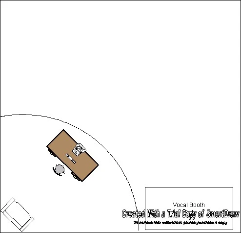

here's a quickie of the "In The Round" control room theory for a standard 2 car garage.....lol

I worked on this last night. I chalked it out on the floor and tried standing in different areas to see how it would function for musicians. I looked like a nerd walking around pretending a level was a bass guitar. I decided I needed a better line of sight so I changed it to two windows. I have tried to avoid parallel walls.
Stranglerfig, I originally was going to try an idea similar to yours with the open room approach, but I figured angling my monitors into the corners was a bad idea. I also thought about facing the corner but that kills the line of sight part.

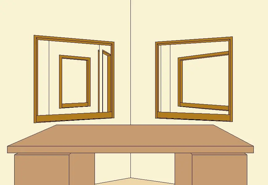

Here is a view showing from behind the "desk" looking towards the booths. Note that I can see into both at the same time. The software is a really old version of Expert Home Designer.

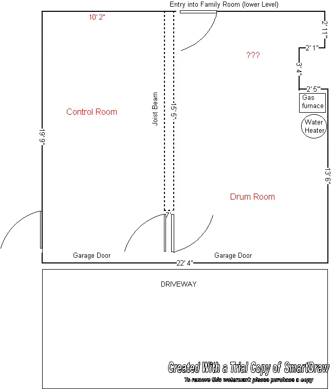

Garagedesign4!
Seriously, you guys should be discussing this over at John Sayer's site.[/QUOTE]
Thanks for the advice. I do appreciate it. I took your advice and tried a corner scheme. I think I can work with these diminsons. The layout is logical and it's probably what I can afford. If you look at the drawing upside done, it makes the "peace" symbol. Random luck...
As for John Sayers site, I've posted three times and got ziltch... I'll post this latest version at Sayers and see what happens.
Let me know what you think...
Thanks!
~Wayne

Wayne,
I think you're latest design is an improvement over the previous, but you still need to tweek the control room a bit. A control room needs to be symmetrical from the front of the room and back to at least a few feet behind the mix position, otherwise your stereo imaging will be off and your mixes will sound off-balance on other systems. Also, the tight corner you have in the front of the mix position will be a major bass buildup point. This could be easily corrected by just cutting off that corner parallel to the console desk.
A simpler idea from a construction standpoint might be to start with a rectangular room that is the same 10 foot width and is 16 feet or so long. Put the mixing desk on one of the short walls. In the corners of that wall, add the angled sections like you have in your latest design on the top to breakup the corners (I'd make them into corner bass traps or soffit mounts for the monitors). What I have in mind is kind of along the lines of what is depicted on the SAE site under the studio plans for the Garage Studio 2, as far as the control room goes.
Anyway, just some random thoughts. Hope you get the answers you're looking for.
