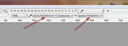

The image below shows a Tascam interface in Audacity. Does your M-Audio show in these selectable boxes and if not can you select it by dropping open the box?

I have an M Track and notice that you say you selected Microphone as the source.
My system identifies the interface as "M Audio Quad USB driver" and doesn't mention microphone.
It might be worth checking in Windows Audio that the M Track has been detected and set to the default source. If that part is okay, perhaps reinstalling the ASIO driver might help.
Make sure you have your input device turned on BEFORE you open Audacity. If you turn it on after Audacity is already opened, it will not recognize your device. As mentioned above, Audacity can not read the ASIO file. The only reason I have Audacity installed is to help others with ACX work who have no other option than to use it.
Audacity will recognize my Tascam 16x8 as well as my Alesis 8 Channel USB and ATR 2100 USB mics. However, it will only record one channel at a time. Your device is a two track Interface and as suggested above, you may want to look into Reaper.
