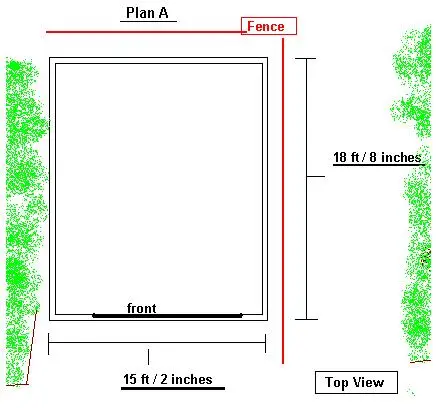

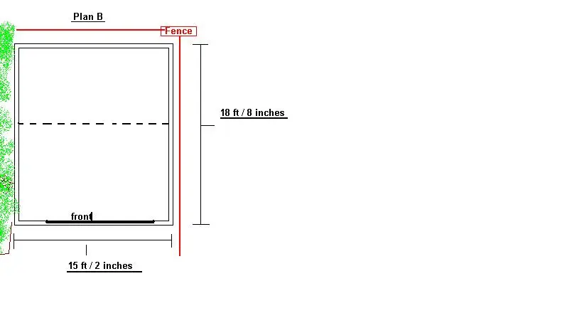

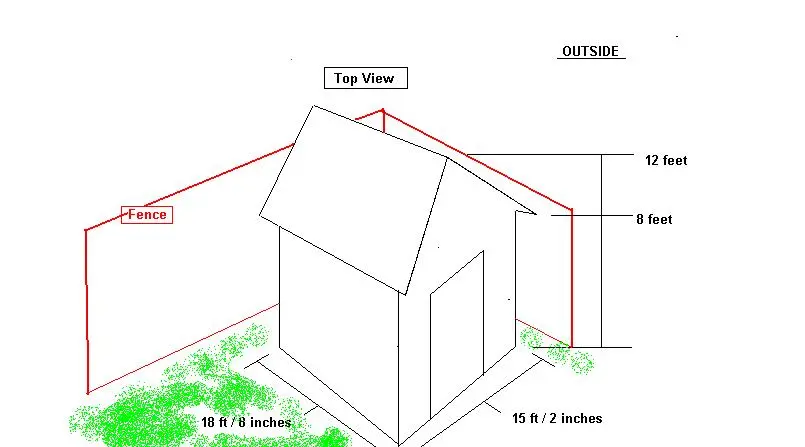

My problem is that i need help decideing on which way and where should i place things (vocal booth,control,etc) in a studio im building in my garage.
i dont need a live room just a vocal booth and comtrol room. if anyone can give me some ideas i will gladly apperciate it.
i have 2 plans (1)plan A.... is to use the entire garage and (2)plan B.... is to use half the garage. so if u giys can give me a good design that can help ...it will make my day
benny

I'm not shure that there is any one off-the-shelf plan that someone could give you that would work in your situation. I think you should break the overall project down into manageable sub-tasks and ask specific question in each area. Start with basics like HVAC, electrical, sound isolation, sound absorption, etc.

On the overall design, I would use the entire space, since isolating the studio from outside sounds (and vice versa) will suck up more space than you think. You will also be adding furniture, instruments, racks, mic stands, and other items which rapidly deplete your available room. Plus, over time your space requirements will expand--trust me!
Also, I have to echo Kristian's warning about floating floors in rooms with eight foot ceilings. If you float the floor, the 2x4's (or 2x6's...2x8's) will sit several inches off the ground on rubber floats (U-blocks if you use Auralex's proprietry product). On top of that you will have a sandwhich of drywall, soundblock, plywood, carpet padding and carpet. The hole floor could run 12" so you loose height very quickly. (You probably won't attract standup bass players or men with hats!)
Benny, your entire space (outside dimensions) equates to about 283 sq. ft.
