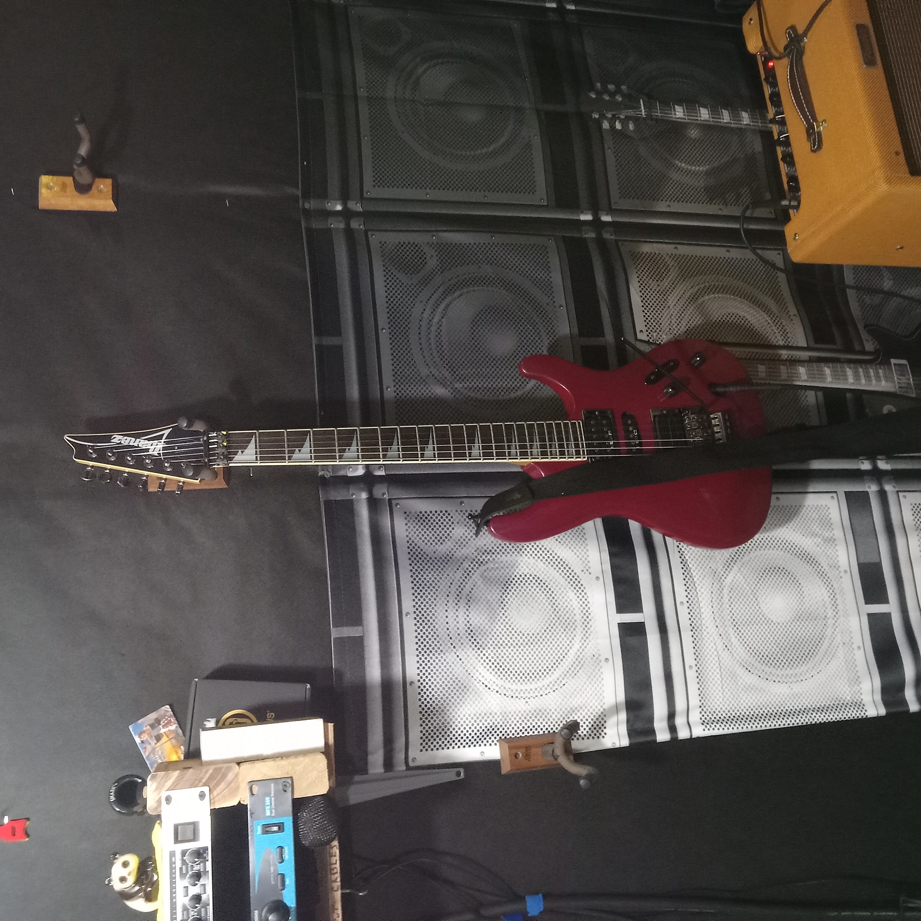

This is a poured concrete foundation wall that I framed with 2x4s 16 in on center. And then filled the bays with rockwool insulation. And then I used landscape weed fabric and staples to cover it.. The weed fabric is what goes in garden flower beds.. it's pretty inexpensive and available at all the home improvement stores.. lowes home depot.. this works great to stop the echo and feedback from sound waves bouncing off a concrete basement walls. I bought a tapestry of guitar amps and stapled that over the top.. and I put some guitar wall hangers up on the studs. As well as hung some of my rack gear as well. My room is on the small side so floor space is at a premium.

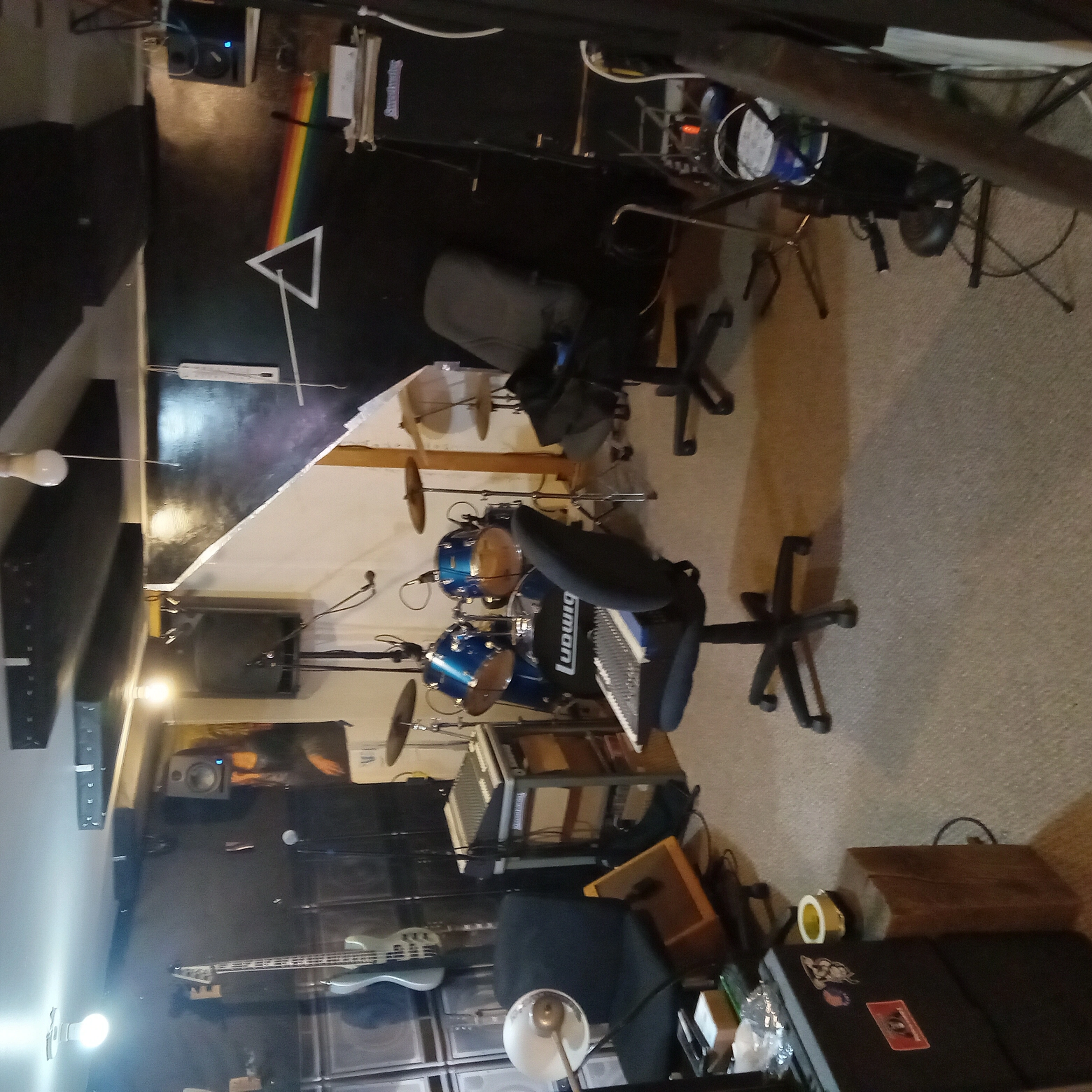

Here is another picture of the same concrete wall.. I didn't frame it all the way into the corner because I have the drums setup in the corner of the room under the stairs and it's a bit tight already behind the kit. So I just used some 3/4 inch thick Styrofoam insulation behind the drums. If you look on the walls and ceiling you can see .I made a bunch of sound panels out of the same rockwool with ferring straps and covered them with the same weed fabric. I hung these home made panels on the celing and on the sheetrock walls.. for the concrete floor I put down a layer of moisture barrier paper like they use under engineered flooring.. and covered the paper with a cheap piece of carpet.. all this stuff is pretty cheap to purchase and with a little time and elbow grease will save a lot of money as apposed to buying professional sound treatments. And it really does make a huge difference in how the room sounds.. my band is 2 guitarist...bass player.. and acoustic drums in a small room and it sound great and records well ..

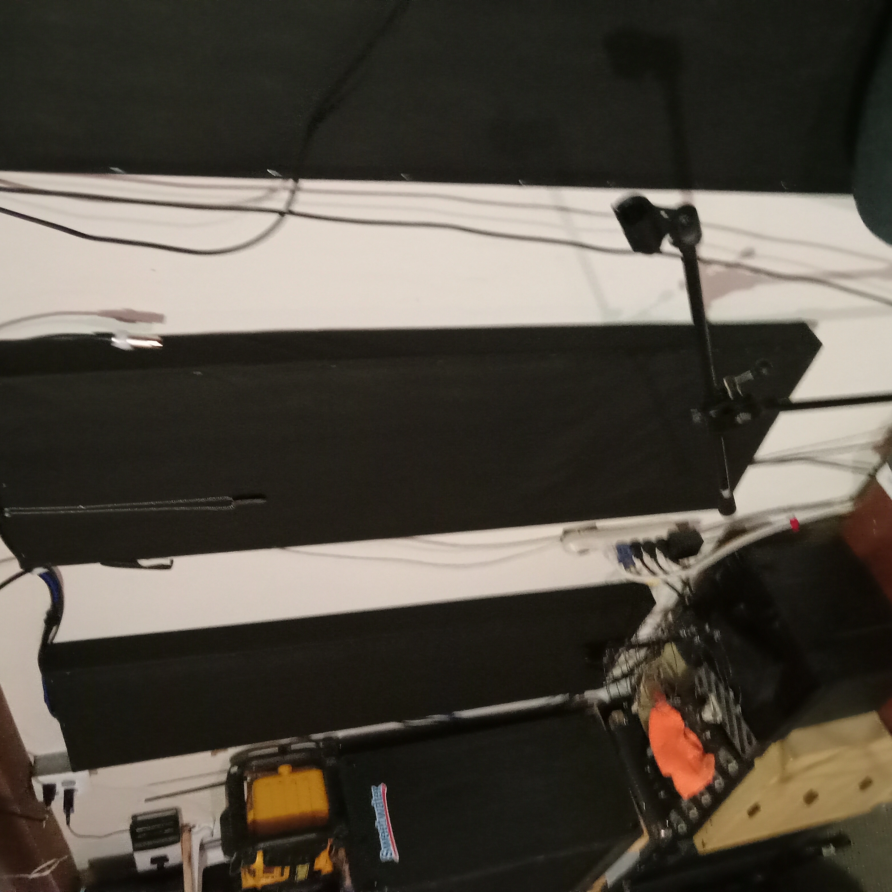

1 last pic of the home made sound treatment panels on the sheetrock wall.. these made a huge difference in the sound of my small studio/ live band rehearsal/ practice room..
