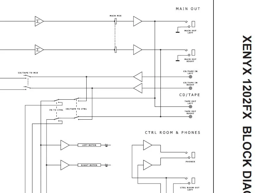

Probably could use a pair of 1/4" TS to 1/4" TS cables as well for the way the RCA's appear to be paralleled up to the Main Outs in the 1202 (unless Dave's seeing something I'm not).
Yeah... that's what I was getting at however you said it better.:D
No Mark, you've got it all there!
I did not find a block diagram (Behrs' used to include them in their otherwise excellent manuals, seems daft to drop them when tis but a byte or two of data?) but reading the text it said the RCAs were just duplication of the Mains.
Pretty poor show really when they really should be attenuated to -10dBV levels, can't think 4 SMT resistors would have busted the budget?
Fortunately I have always found Behringer mixers to be pretty low noise (despite what the haters say) so the Main OP control can simply be backed off to avoid overloading the Tascam.
