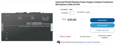

Hi,
I'm still gathering kit and have now bought this;
I've also bought a laptop but not managed to connect everything up yet although I'm trying. I'll eventually win in the end.
Kind regards, Colin.

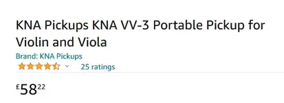

Hi,
A lot of progress this morning thanks to your generous help Brody; I've not relocated the monitors because I wonder if it's worth the time and trouble given my small studio but what I've just done was to disconnect the passive monitor; this is the monitor very near the mic; I can now switch everything on without the monitors going ballistic due to feedback; I found I could induce feedback to the active monitor be carefully turning it to a point where feedback was starting to be present but because of the low volume setting I couldn't play back the violin but by tapping near the mic it picked this up through the monitor so yes the problem as you rightly pointed out is due to feedback.
Now with this information I think I might be better going the electromagnetic pickup route so I can easily switch between Rode mic and the violin pickup?
I've done a bit of web browsing looking at various violin pickups and these vary greatly in price;
Perhaps something like this would be OK for my hobby need or any other that is recommended.
Fishman generally makes pretty good stuff. Their piezo systems are standard on a lot of guitars.
Should you find the sound not to your liking compared to the microphone, I would also suggest you find a nice stand. Then you can place the mic a good distance from the speakers and orient it properly.
A simple K&M 260/1 stand is only £27 from Thomann. Sometimes you can find them at the local music store on holiday sales for less. Check places like PMT or Andertons.
