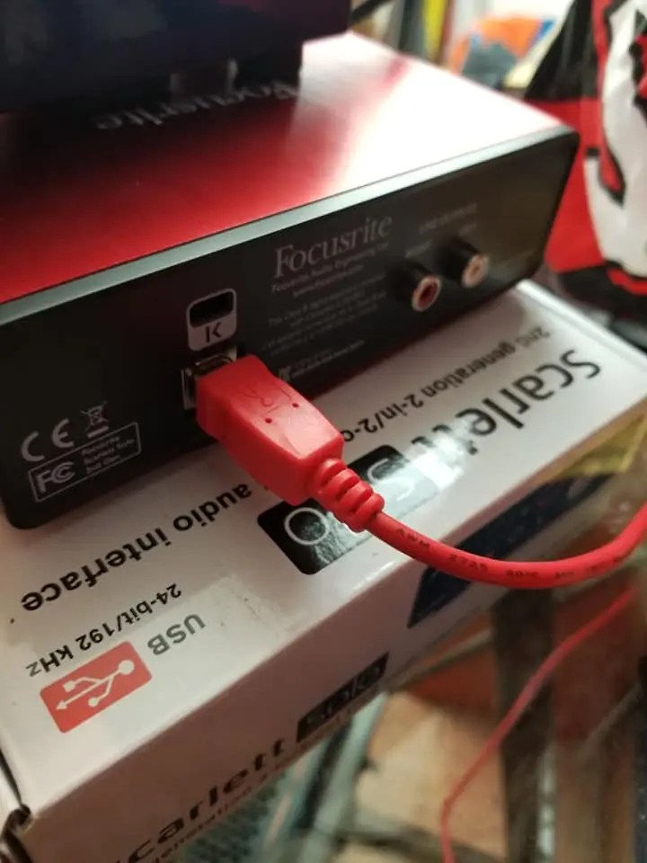

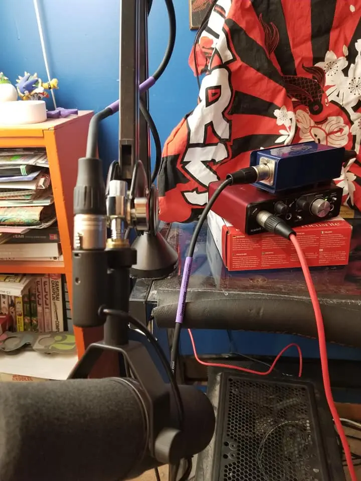

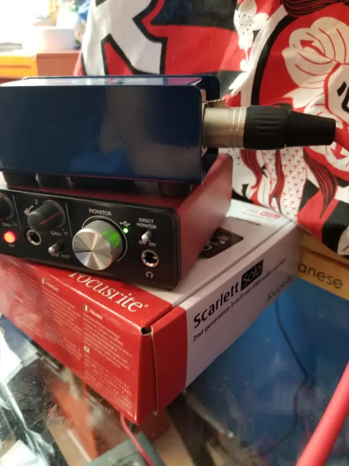

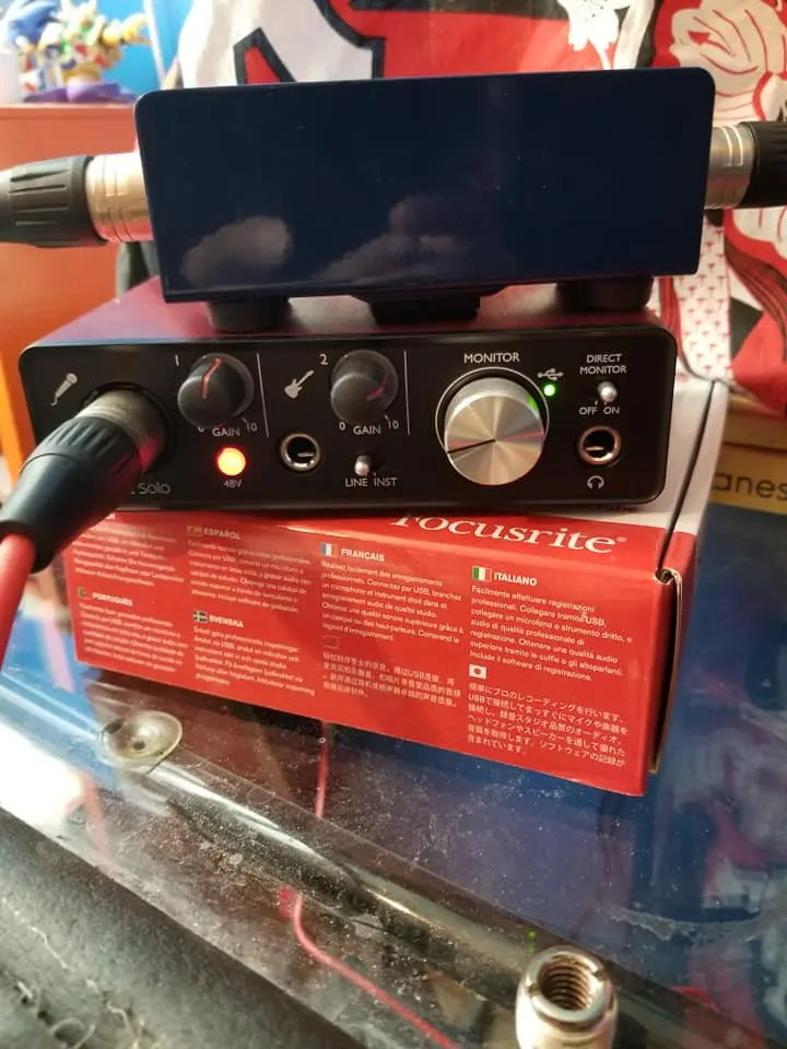

Here are pictures of my simple setup. Thanks for helping out. 36864567_1958691327474549_8003368494613659648_n.webp36864582_1958691527474529_728323825158062080_n.webp36812686_1958691480807867_7936538734768422912_n.webp36854866_1958691600807855_1398067315760693248_n.webp36890698_1958691687474513_8157155480888672256_n.webp
GG,
The pictures helped to answer a question that I have been pondering of whether or not you might be using 50' long XLR cables. I am assuming the purple-flagged cable is not, and the red cable is the one that came with the FR.
I see your mic gain knob at 12-1 o'clock. When you are speaking into the mic, are you seeing any color activity: green, yellow, or red ring around the knob?
How close are you, when addressing the mic? This is a broadcaster-type mic that likes for you to be closer to it, unlike your CM-25, which is more sensitive.
Like ECC, I want to throw another WAY OUT there test: have you tried flipping the switches, on the butt-end of the mic. Set them to Flat Response, test, then other settings, etc.

The purple XLR is 10ft. Not sure what the red is, I'm assuming it's 10ft as well. Third XLR pretty sure is a 50ft.
The way I was taught when speaking into mics is to make the "I Love You" hand sign, spread my thumb and pinky as far away as possible. Then put that distance between my mouth and the mic. That has worked with the SM7B before. Doing another test, I don't get any color around the knob. On the playback of a recording I can hear myself but it's about -45db. Again, when I crank the knob to 5 O'clock, the audio waves are nice, and the knob is green. I tried adjusting the frequency switches on the rear. No change.
You can get literally right on the windscreen of an SM7B. The diaphragm is quite a ways behind the end of the foam.
But I don't think that will solve your problem. It sounds like a cable issue but the condenser working on those cables argues against that guess.

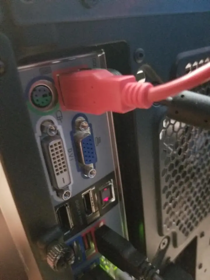

Minor correction to ggbriandee, not that it changes things much..... the thread started out about the Focusrite 2i2. The interface in the pic is the Solo :)
- I don't know if it makes any difference, but evidently the USB ports you're using in the pic are USB 3.0 which can supply a higher current for charging devices than what a USB 2.0 can do. As long as it's "clean" DC from the port and there isn't some weird setting in the computer on how it works, the red USB 3.0 port should provide adequate power to the Solo. You said you had tried other ports. Were those also red USB 3.0 ports? If so try a non red one which may be a non-charging port. Charging a battery in a device does not need 'clean' power and might be less filtered (just speculating on this).
