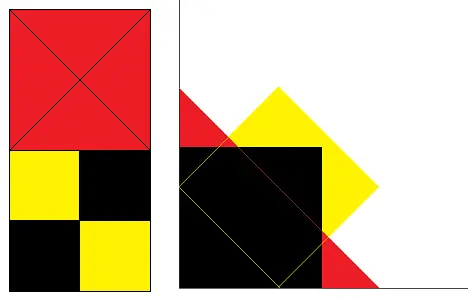

You said you made 8 triangles by cutting the 4'x2' in half, then diagonally into quarters. I'm talking about doing the exact same thing, just cutting horizontally and vertically rather than diagonally. You use the same amount of material, but it may be more effective (large surface area, constant 12" thickness, and still 17" at thickest point).
Only acoustic benefit I can see to triangles is that they extend further along the wall, however this is just 5" more and it's thin (0"-5"). On the squares, instead of being thin at the edge, they add to the overall thickness. I'll draw what I mean. Red is normal triangular, Black is what I'm talking about, and Yellow is what you could do to improve its performance further. Get it? :p

ahhh....I see what yer sayin. Makes sense.
Seems like havin the square out from the wall giving you air space behind it would help with the trapping too.
....seems reasonable to me. :drunk:
