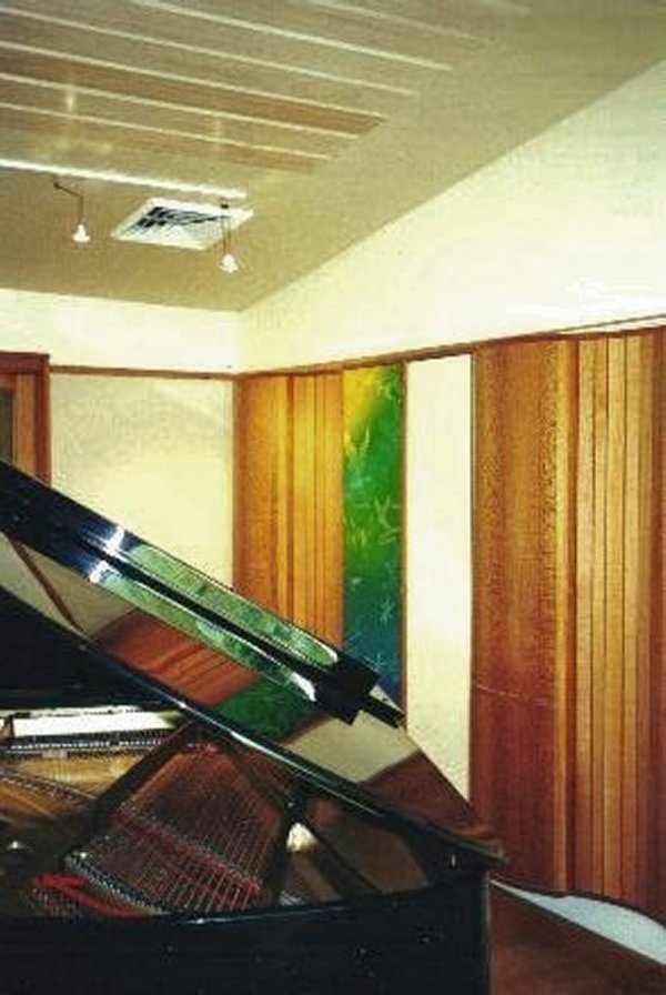

Yes you can put a resonator in the ceiling - here's a pic of one
Putting rigid insulation totally will create a really dead dead room with no high freq response. Slots like in the pic will give you some high end diffusion which is what you will need.
cheers
john

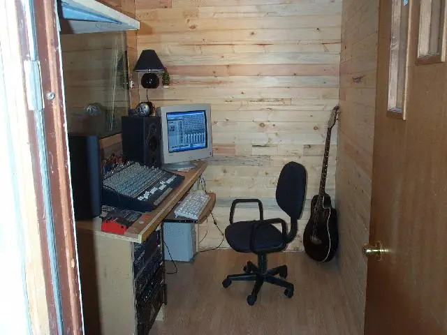

thanks for the info. does anyone know the best way to make this size room workable. my mixes turn out bass heavy. attached is a picture.

John,
> Yes you can put a resonator in the ceiling <
Thanks for correcting me. But in a 6x9 room? On the ceiling? Really? :D
--Ethan
Not that I am pretending to know what I am talking about, but why not put one behind you?
yeah - why not?? Most people ignore the ceiling as a treatable surface yet in a small room it's possibly the only area you can get depth without loosing floor space.
cheers
john
i know nothing about acoustics, but he says his mixes turn out bass heavy, which means he's not hearing enough bass in the control room. Is this resonator actually adding bass by resonating at a specific frequency? I've heard of bass traps, but never acoutic treatment thats add frequencies, this is quite interesting!
Eric
The paradox is that using bass traps can INCREASE the amount of bass you hear in the room. What you are doing is keeping the low soundwaves from being cancelled by the echoes.
-lee-
In a small room like that, there's a very good chance that your head is located dead center in all three dimensions, or at least two - whatever frequencies those modes are at will be almost perfectly NULLED in the center, which would definitely make you turn up the bass.
Assuming an 8 foot ceiling (not mentioned) the primary modes are at 62, 70 and 94 hZ. Hearing little or none of those would make ME reach for the "Big Bottom" knob... Steve
cheers
john
And most people, including myself over the years, forget that a ceiling is nothing more than a parallel wall to the floor, awesome way of getting standing waves.
That was a lesson I unfortunatly learned the hard way loooong time ago.
thanks for the comments. the ceiling is 7'-6. i have some time to build the resonator. i will let you know how it works, also i have a friend that works at an insulation supplier that carries 703. how do you know how much 703 is required.i will put 1" in the resonator , but how much on the walls?
when i mix , i am prety much dead center of the room
thanks for the help.
