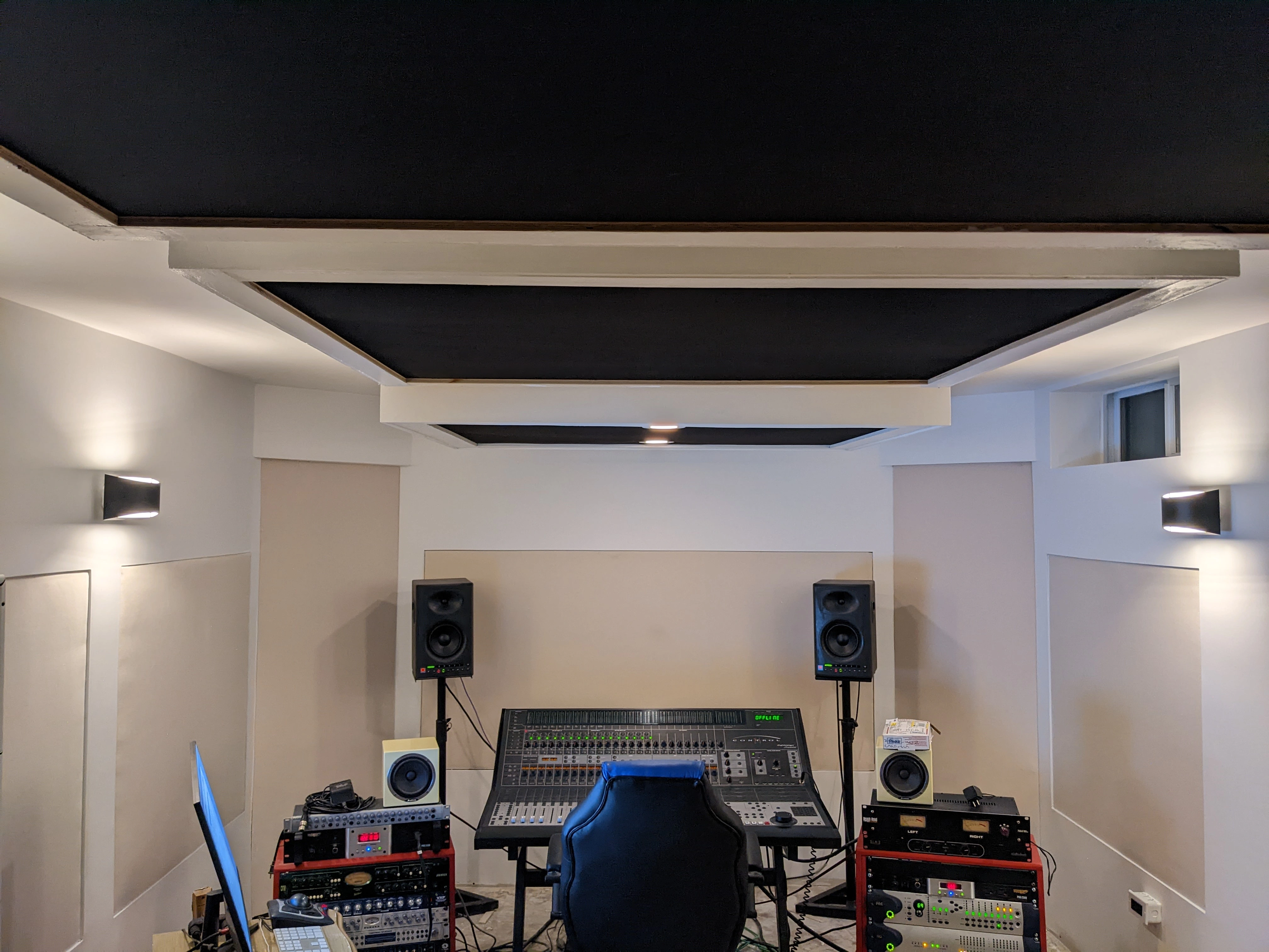

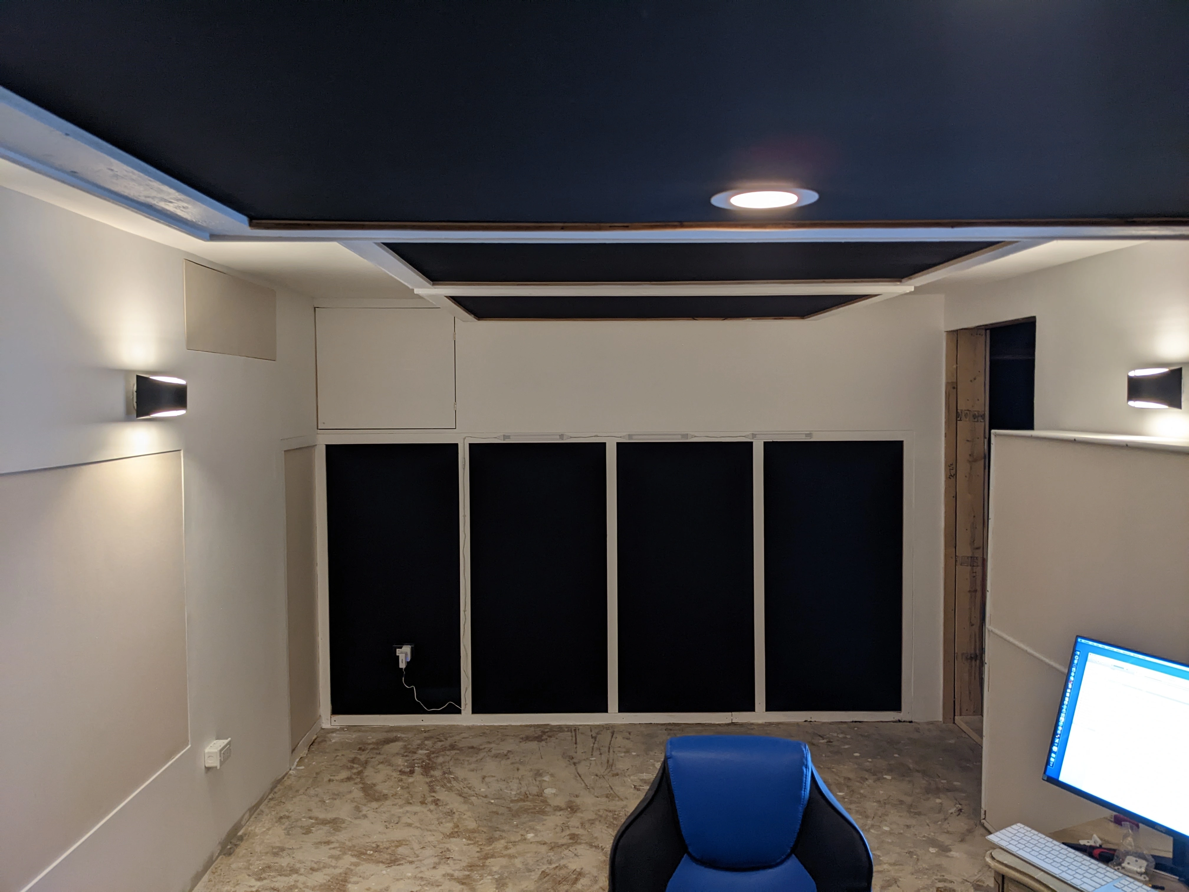

John, I'm getting a Helmholtz resonator that 4 x1 foot, I noticed infront of the 1st ceiling cloud when I stand up there's lots of bass, can I mount the Helmholtz resonator on the ceiling before that cloud? There is a space of 2 feet between the wall and ceiling
