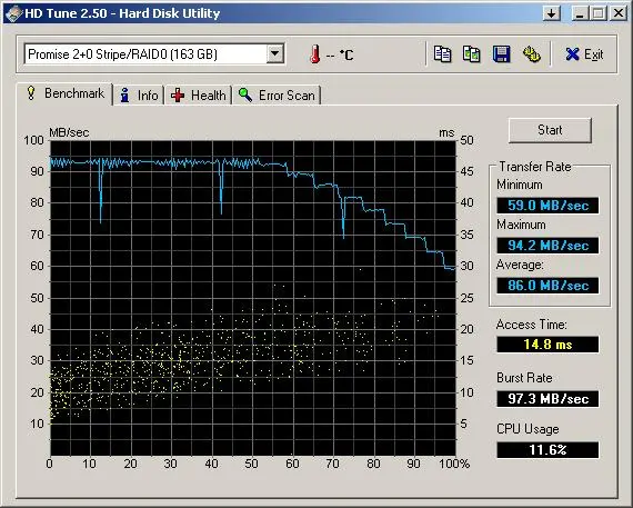

I found this free utility to measure my hard drives to make sure I'm picking the right one for audio data.
HD Tune
Do you see any reason that Pro Tools acts like it likes my firewire hard drive better than my raid-0 pair (see graph)?
Here's the firewire drive benchmark...

Oh yeah.. There is glitching... Pro Tools won't even play/record when the audio is on any other drive than the firewire... Even though we just proved that the Raid pair is sooo much faster (go figure!). That doesn't really sound that bad, right? Except for the fact that I get artifacts in my recordings when the audio is stored on the firewire drive. So you see? I'm rendered incapable of recording anything through Pro Tools and I must figure this out ASAP... If you look above, you'll notice the difference in CPU usage. I suppose that could be the problem but hopefully the following will save me....

Ok, I may have missed it........or you may have edited your post.......glitching. You don't have any glitching problems with your firewire drive? It seems strange that your raid drives have a problem with glitching when the transfer rate is like 5x that of the firewire. Have you tried a non raid config with your internal drives? I remember reading about some folks having problems with SATA drivers. I really have no clue. Wish I could help.
