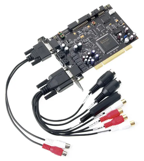

Is this cable balanced and what is importance of balanced inputs ?

please , Another one question ... Do I have to purchase this balanced breakout cable to use it with Presonus Eureka ?
I think there is no xlr or trs inputs in the cables which come with the card , isn't it ?

Yes, you are correct. You will need that breakout cable. Balanced cable uses 3 conductors, unbalanced only uses 2. They are not interchangeable without using adapters and transformers.
A Balanced connection will filter out unwanted radio interference (buzzing) that can occur when running cables a long distance, perhaps more than 10 or 20 meters. With short cable runs, radio interference is rarely a problem. Therefore, with cables of only 1 or 2 meters, no difference would be noticed between balanced and unbalanced signal quality. However, you will need the breakout cable to match the signal type and sensitivity of the Presonus.
