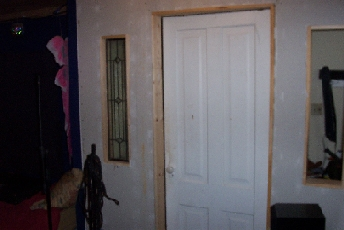

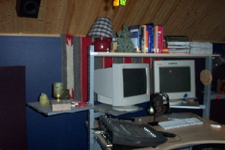

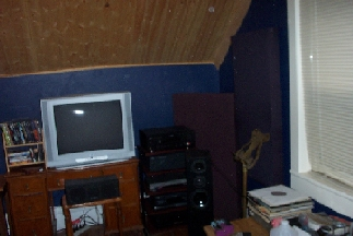

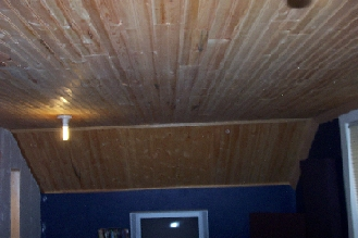

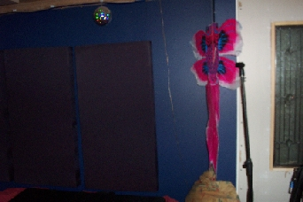

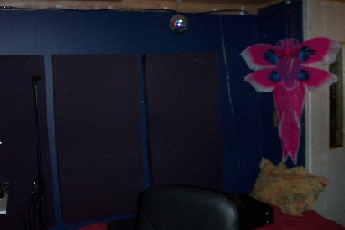

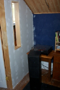

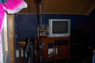

Ok I ran out of money and what you see in the pictures is where Im at and could use some tips from all of you studio geniuses out there. One question about the panels...so far I have 7 2" panels on the walls 3 4" bass traps and 2 2" ceiling panels. So what Im asking is how many more panels should I make from each criteria that I listed juding from the pictures. Thats about it for now...if I think of anything else I'll post or if anyone else has any ideas about this project please share. I am in the middle of putting up a wall just started framming and putting the door.

the ceiling is awesome.visually and angually..or is it angular ally..or..er :confused:
damn you didn't scrimp on the traps either..very nice.
i don't get the speakers on the ceiling thing? are these for monitoring, non-nearfield?
clouds too....damn i feel lazy now. :p
Those little mounted speakers are the rear channel for the home theater, but right im using them to do some acoustic work cause as you can see I dont have any monitors yet.
Well there would be more traps up but Im pretty someone stole my powered staple gun....musicans. So I'm at a stall for now. For the ceiling I have 2 panels set up im just not sure how many more I need up there...
Well im thinking 2 more bass traps one where the turntable is and the other below where the pink kite is. Where the pink kite is theres a little corner there Im just not sure If I were to put a bass trap there would it do anything cause its pretty much in the middle of that wall.
