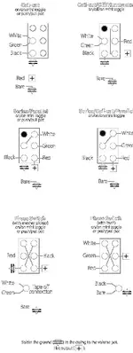

So I looked at the diagrams there and I can't tell how to read those. I'll put a picture of the diagram and yeah.
So I'm guessing I'm dealing with a Phase Switch(with two humbuckers) And that I hooked them up wrong or something? I'm using a gibson p94r for my neck pickup and a Seymour Duncan SH-14 Custom 5 for my bridge pickup. The diagram I'm posting is for Gibson pickups apparently. I'm not really sure how to read that, so if someone could explain what's going on, that'd be awesome.
Thanks
-Elliot

The diagram you have there is using mini toggle switches. Here is a Les Paul type diagram using a 3 way switch that is used in a Les Paul/SG etc. type set up. It may be closer to what you're wiring may need to be.
http://www.stewmac.com/freeinfo/I-0133.html
Heres a link in case diagram wont open...

That diagram doesn't make any sense to me really. I have an ESP LTD F-100FM Guitar. So if anyone could find a diagram of that, or I will post a picture or something and people can help. But yeah. The pickups get wired to the switch which is then wired to the volume and tone knob.(there is only 1 volume, and 1 tone.) IF that helps at all, thanks for the help still :)
-Elliot
