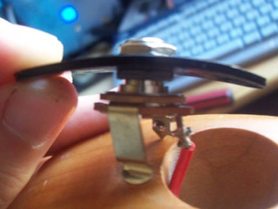

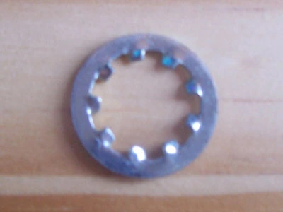

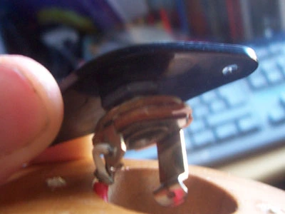

I'm using a Yamaha Pacifica 112, I don't know if this has anything to do with my problem (and if anyone can help me on this anyway) but when I first got my guitar the (don't know the technical term) hole where you plug your lead into was loose so I undid the screws and tightened it but when I undid it this little washer popped out and I've no idea where it came from. I'll enclose some photos of the washer etc. to see if any of you guys might be able to enlighten me on where this washer goes...

Not sure about the washer, my first thought is that it would have come from around the end of the jack socket between the end of it and the nut that holds its in place. But from looking at the pictures I'm not so sure.

That washer gets on my nerves. I know it should be in my guitar and it's not. It functions fine without it but still...
That kind of washer is usually used as "lock" washer. So I would normally expect it to be between the nut and the guitar body/pickguard/whatever. But you can obviously use them for just about any washer use.

Yep, it's a lock washer. It should go on the underside of the mounting plate or pickguard. It's purpose is to keep the plug from turning, the pin should be turned toward the uppermost side. The weight of the cable pulling down puts more pressure on the top of the jack tip. Hope my explanation makes sence, anyway I am sure about the washer and where it goes.
Yeah, it's a lock washer, and it goes against the inside face of the mounting plate. But that is not what is causing your problem.
