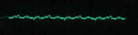

Well, we we're working with two different units that probably have different problems. Mine has undetectable ripple at the output of both 24v supplies at the outputs of the PS board. With the connector unplugged from board 6, there is also no ripple at 24v on the cable. But when I plug in the connector giving power to the eq boards, a signal is present of about 2mv on the 24v supply on the boards. Removing the jumper from board 6 to board 5 minimizes this signal to well under 1mv. Leaving board 5 powered, and removing the next jumper to board 4 has a negligible effect - the signal is still present at about 2mv.
This same signal is present at the outputs of all the eq boards, at about 3 to 4mv. I can't seem to be able to separate this signal into discrete frequencies - it's basically a blur on the scope at any setting. There seems to be a component in the 60Hz range, and another much faster one. Here is the slower component:

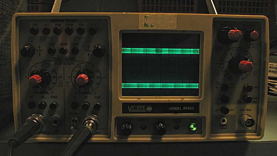

Here is the faster component at about 50kHz - probably beat frequencies. The upper trace is at the oupupt of board 5 (about 3+mv), the lower is the 24v supply on that same board (about 2mv). I really don't know what to make of this, except there seems to be an oscillation induced into the power supply traces on the boards by the eq circuits.
I haven't swapped the transistors, but they are only running at about 38 degrees C, measured by a thermocouple in contact with the case. I guess that will be the next attempt at a fix.
