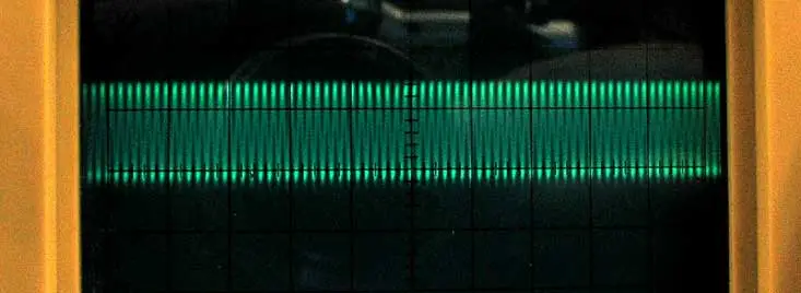

Well, I finally feel like I've made some progress on the noise problems with the 1081 I've been working on.
I think the most important point is that the problems with these are multifactorial. I've found three with this first unit (besides the switch pop), and dgatwood and others have found others.
1) The output connector (from the power amp board at the output gain pot) was loose (partially disconnected) - this was the easy fix.

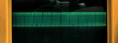

2) There was oscillation in the eq section (see pic below). In this particular unit I finally ID'd it at 70MHz - about the limit of my scope - and about 8mv as measured at the output of board 5. This was present on all the eq boards and on the +24v rail that powered the preamp and eq sections. I don't know why this affected the audio signal, but it caused buzz at the audio output when the eq button was engaged, despite all the eq section switches being in the off position. The problem was worse when eq sections were engaged, especially the two inductive ones.
I swapped out the Q4 and Q5 transistors in board 5 with a 2N2222 and a 2N2907 (as I had these around, they have similar characteristics to the original Neve BC441 and BC461, and are a hell of a lot cheaper) and this reduced the magnitude of the oscillation by over 50%. I switched the same parts on board 4, and the oscillation disappeared completely.
Now with all the eq switches off, but the eq pushbutton switch engaged, there is no noise. However, engaging the eq of board 5, and to a lesser degree board 4, does insert some 120Hz and harmonics noise into the output, augmented by the boost control, but diminished by cut.

The voltage is 33v give or take 0.2v at the rectifier output (regulator input - measured on C9 and C14) of each 24v supply. The ripple is a sawtooth 120 Hz of o.2v on C9 and 0.1v on C14. Output ripple is an unmeasurable <1mv on each.
Before replacing the output transistors on boards 4 and 5 (the ones with inductors), there was a 70MHz oscillation of about 2mv in the regulated output of the PS on the eq boards. Removing this oscillation quieted the output considerably, with only 120 Hz noise left when boards 4 or 5 are engaged, presuming at this point it is induced EMI from the PS toroid.

I'm seeing the noise only when the supply is unloaded. The part in my reworked supply isn't a 7824. It's an NTE972. In theory, that's supposed to be an exact substitute for the 7824, but reality often differs from theory when part substitution comes into play. The 972 might be linear, but the specs don't say. All the other parts in that range explicitly are described as linear except for that one and a couple of others, so my guess is that they've updated the part specs to use a switching regulator, but I don't know that for certain. If it's not a switching regulator, then I have no idea what's going on. Maybe one of the new diodes is bad or maybe one of the big supply caps is also bad. *shrugs*
Either way, the caps on the EQ boards seem to be pretty much cleaning that up, so I doubt that further power supply fixes are going to help unless they involve moving the transformer at least a foot outside the unit or replacing it. That doesn't mean I'm not going to try, but I'm not holding my breath. I'm probably going to switch back to the original 317-based circuit, but with the upgraded diodes.
