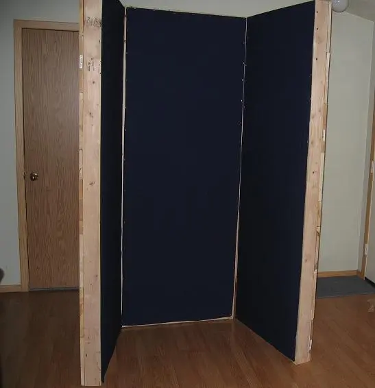

I build two foot by four foot wood frames, stuff them with rigid fiberglass, and then attach them to microphone stands with pircture frame wire.
here is mine that I just built - kind of a makeshift vocal booth.

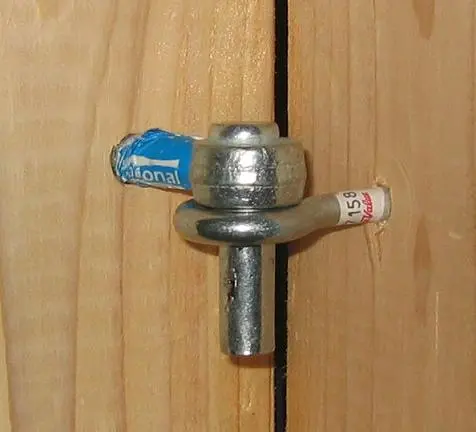

Looks good. I can't tell if you've hinged the panels together; I think I can see a piano hinge in there.
Actually they are hooked together, but by eye bolts on the outside panels, and gate hinge "hooks" on the middle panel - so they can be easily seperated when not being used as a vocal booth.
