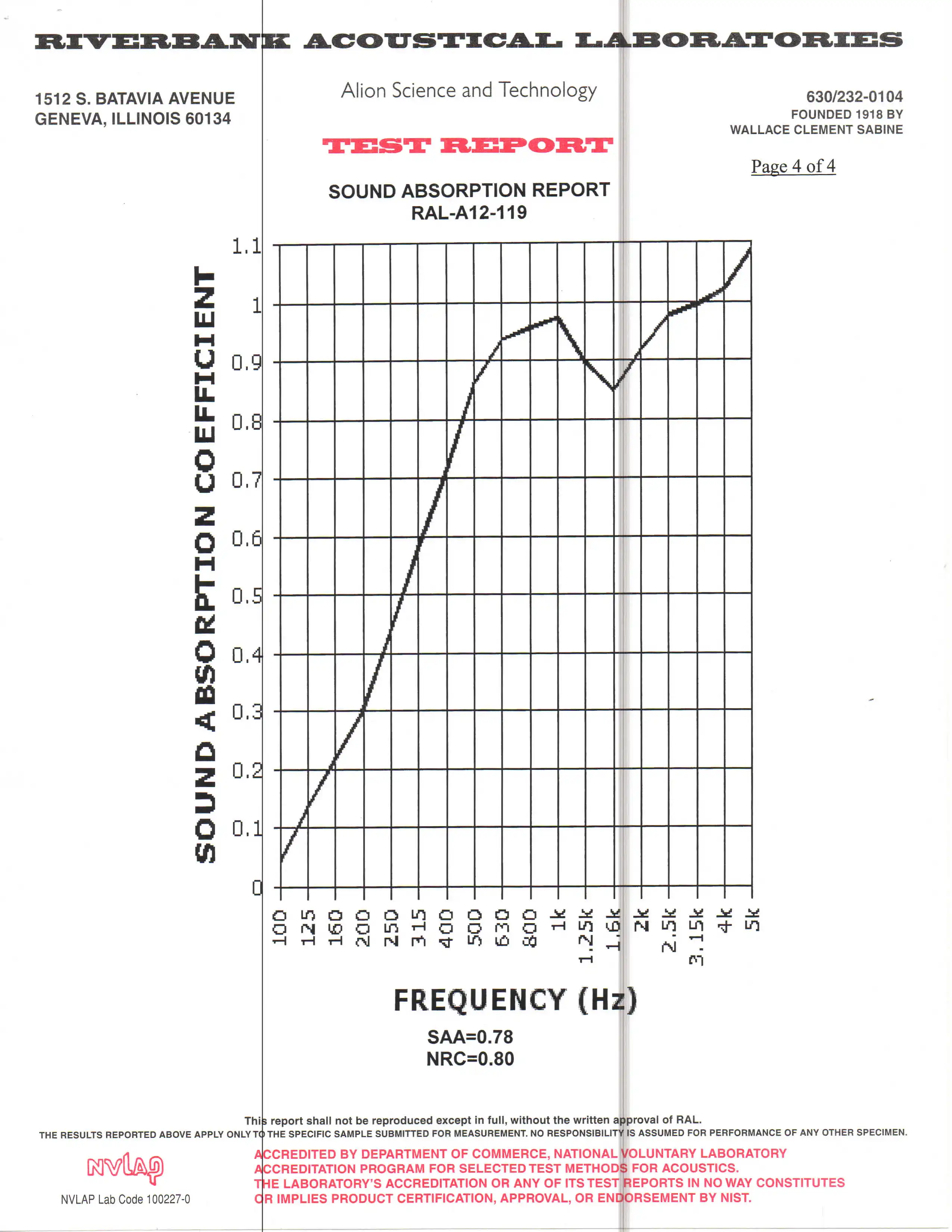

I keep looking at the GIK site--mostly because of the model. But I don't see any data on the actual effect of the screen. They say it operates down to 150hz. But I'm unclear what that means in terms of absorption. It's just a two inch panel. So lacking some other kind of structure (like a membrane) how much will it actually absorb? Even a thick moving blanket will absorb that low. Not much but some.
This is a little odd for GIK because they almost always post independent test results.
The other thing I can't get past is their insistence on calling it a "booth" and an "isolation" booth at that.
It limits reflections on the absorption side, but as far as I can see it's not a booth. I also can't imagine that it has significant isolation properties. It will reflect some sound on the back side but that's hardly isolation.
Maybe I'm barking up the wrong fire hydrant, but this just seems sloppy to me. Especially, for these guys.
NOTE: ATTACHMENT IS BLANKET DATA

I take that back. It is a booth if you buy four of them and put a lid on it. :D That would only cost about $1300. Of course, that is pretty cheap compared to the skyrocketing costs of most top level vocal booths.
Yeah it seems like the gobos are basically just free standing covered rockwool or equivalent. But since I'm not really looking for isolation, I'm okay with just damping some high frequency ambience. I can always low pass any unwanted bass/sub bass.

I have pretty much decided I'm going to get these 2" deep gobos. The 4" deep are only 50 usd more for the pair but, i just dont think i need them that thick. And I can always get one or two later , right?
