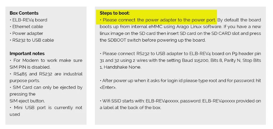

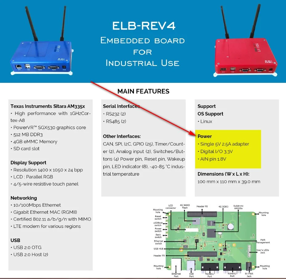

Hello everyone,
How do I Powerup ELB - REV 4? Can I do it using an USB? Or will I be needing an Adapter?
Regards,
Sandhya
What is it you are attempting to accomplish related to audio recording with a SCADA device? :rolleyes:
The documentation infers that the 'Adapter' would be required.
You've made other inquiries regarding the ELB REV4 on other forums as well that the documentation should be able to provide. Failing that, contacting the manufacturer or sales folks should yield the needed information.
