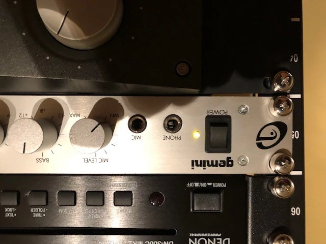

I have a older Gemini PA-7000 preamp. I tried to use the mic jack and nothing but a pop, when the mic is plugged in, and as I start to turn the mic level up, then nothing. I am trying a Behringer xm8500 dynamic mic, a xlrf to 1/4" trs cable. Then I added a 1/4" trs to ts adaptor and the same thing. I have attached the schematic. I don't know if this is the correct mic setup or if the preamp mic circuit is bad. Everything else on the preamp works fine.

If you have an instrument/patch cable (1/4" TS both ends) plug it in and touch the tip of the end of the plug of the cable while increasing the gain on the amps mic channel. You should hear some hum.
If you do hear hum I'm inclined to think the TRS to TS adapter may be a problem and I don't believe the XLR to TRS cable will work. If you hear hum we can work on finding a cable that may work.
The schematic of the mic input jack on the amp I 'think' is wired with a shorting contact so that when no plug is inserted the output of the last mic gain stage is shorted so as to kill any noise of that preamp channel may produce with nothing plugged in. It may be in part the reason for the pop when you plug into it when it opens the short.
The amps mic input has a 3kohm input impedance. My first thought was that transformer as well and I have several around from my early years with old 1/4" input recorders and amps that had hi-z inputs. Might work, but I was thinking more more of an XLR to 1/4" TS cable that unbalanced the 1/4" connection (XLR pin 3 to shield/Gnd) to the amp which I've used occasionally with some gear I have.
Foremost the OP needs to be sure the input is actually working, which I tend to believe it would be.
I have tried a guitar cable and yes I do hear a hum when I touch the tip. The mic level does not change the hum but the volume output of the preamp does change the hum. Also I looked inside the unit the mic jack is in a plastic modular case with a clear top and I could absolutely see a set of contacts making and breaking. When I plug the microphone with the XLR to TRS quarter inch cable into my guitar amp and I turn it up pretty loud I could hear my voice just a little louder than normal speech. But when I add the TRS to TS adapter I don’t hear anything

I am attempting to acquire a second Gemini PA 7000. That way I can test for similarities and differences. Plus I really like this preamp and I’ll have spare parts and I’ll be able to experiment with upgrading the Op amps. The thing I really don’t know is if this input is balanced or unbalanced ( trs or ts) maybe next time I open it up I’ll get on the circuitboard and do some testing. By looking inside the unit I really can’t tell because the mic jack is in a housing and I don’t want disassemble it. I really don’t mind buying small items and testing but first I need to find out if this input works. I was trained in electronics but I’m an electrician I don’t have any test equipment like oscilloscopes and I don’t have a service manual the manufacture said one was never made for this unit. So hopefully I get the second unit and I can start there. Thanks all.

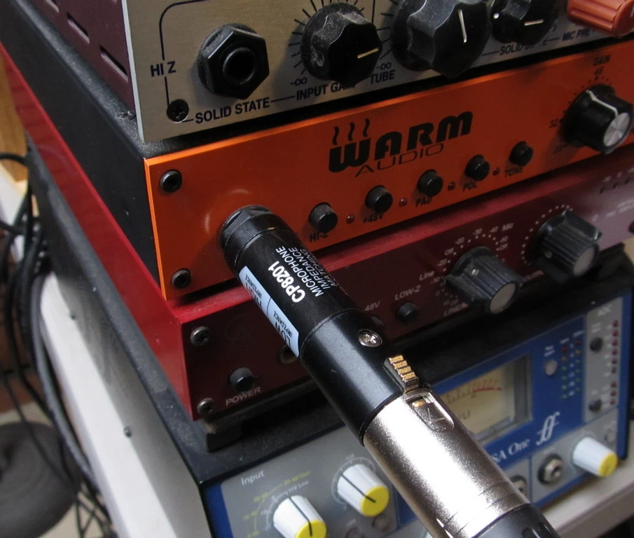

The transformer do three very valuable things...
1) give the mic a differential input.
2) Boost the signal by at least 10dB.
3) Stops RFI which plagues such simple mic stages.
They also cost little more than another cable. Back in the day we used Reslo RB ribbons in the 'group' but these were high impedance types and went straight into the 50W Carlsbro amp (along with two guitars!)

The transformer? is this the inline type. Are they available?

Transformer is inline and generally plugged into the jack on the amp or other device you're wanting to match up to. I wouldn't normally use it on the preamp below, but just an example how it would plug in. Hold off getting one until you know the preamp input jack is working, either on the one you have or the one you're getting.
