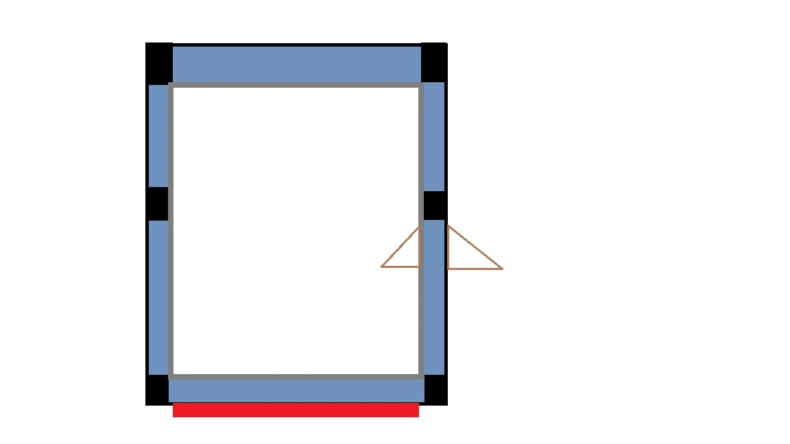

This is an odd idea. I've considered putting in a small (voice, not music) recording setup in my 2 car garage and am looking at these small storage sheds you see outside Home Depot, etc. Any thoughts?
Yes, why? I mean, do you have a noise ingress problem? If so a shed wall (wooden?) is not going to stop a lot. There will be some noise reduction due to the change of boundary material from air-wood-air but since the shed will probably leak like sieve, no great gain.
I CAN see some other advantages however? You could do some soundproofing, plasterboard externally and not have to worry about weatherproofing. Tidy place out of garage mess for mics etc?
Still going to have to treat the crap out of the inside though otherwise it will sound like boxy hell.
