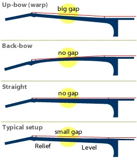

You can look down the bass by holding it eye level with the bridge end near your face and the headstock away from you. Focus on the edge of the fretboard. You'll see if it bows inward or backwards. View the pic below.
Figure out which way it's at, then I'll tell you which way to adjust it, if needed.

.....got a little bit of back-bow, still...
That's probably your problem, but you should check the neck for twist as well. From the headstock end, look down the fretboard toward the pickups. All the frets should be parallel. If they are not, then you have a larger problem.

Loosen the truss rod, SLIGHTLY. Then check it. Continue until correct.
