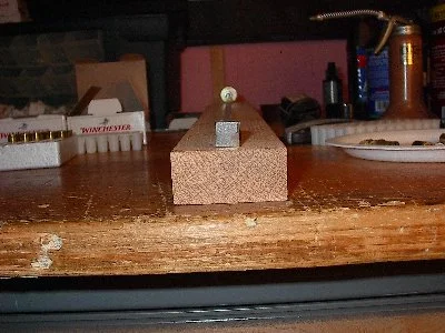

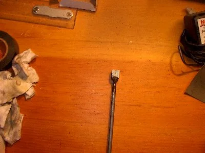

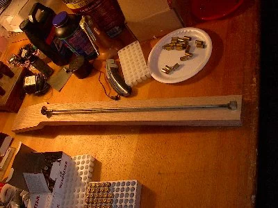

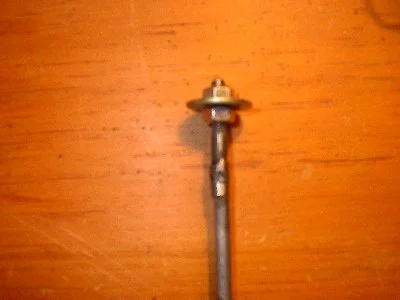

Theres my truss rod and I havent shaped the neck yet and Im now convinced to buy a fret board. I heard you should wrap your truss rod with teflon tape the stuff they use to seal threaded pipes so it does not vibrate but im not sure on that one.
Mutley600 do you think it would be okay if i use this one instead of a non adjustable rod like a t rod or square. This rod is not perfectaly strait i know that.
And i will be using a router mounted under my work bench with a fence on each side to route the slot for the truss rod. If i use a t rod or square rod will i need to anchore it at all or just make sure it fits snugly in the neck?
