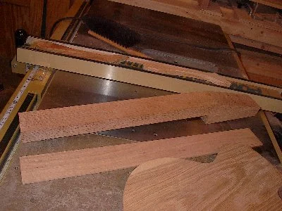

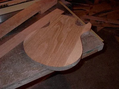

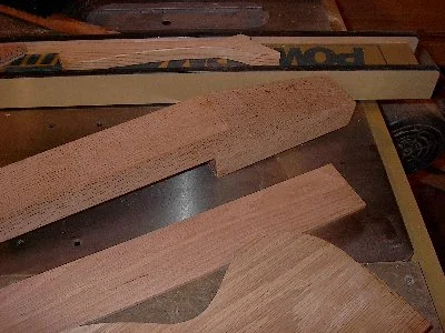

YAY i got em on finally
marshall.....I stand corrected....you seem to have a good grasp of what you are doing, go get yourself a fret scale and make a bunch of guitars....hell....I'll buy one if they sound good!!!!
Wow those pictures suck! I will post some more once i make some more progress.
