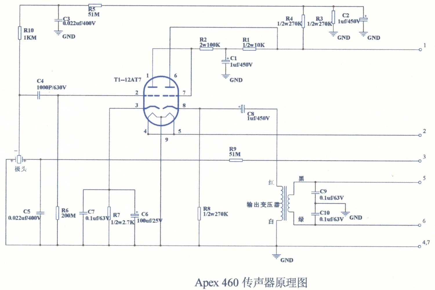

Below is a schematic for an APEX 460 (couldn't find one for the Badaax T-11A). Pin 1 might read up around 540kohm in the APEX through R4(270kohm) and R3(270kohm). What value of ohms did you measure and did it start at a low value and climb (capacitor charging)? If a schematic was supplied with the Fox mod, is it connected similarly to what is shown in the APEX? Kinda hard to troubleshoot without a schematic of sorts.
Yeah, Pin 1 seems to start low, and then rises up to ".535-.540" on my DMM and stays there. There is a schematic on the back of the book. I will attach it later on when I can get to it. Ill be honest though, I haven't really worked on electronics to this extent, I was just following the books directions step by step. The soldering/connecting everything where it needed to go was easy. All tests verified proper wiring up until this point. Only thing it had me test that "failed."
Yep, that's what acaxis said. 0.54M = 540K. It starts low and rises as the cap charges. Something pretty much has to connect those ground points to the chassis exactly for shielding purposes as bsg said.
