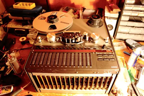

Also bought one dirtcheap, replaced the drivebelt, It's running smooth but... No record function...Tryed a bunch of tracks not all yet.. It monitors fine though..
I hope It's not too big of an issue!
Sorry to hijack your thread here, but I have a feeling you are experiencing the same issues as I am
I now see the tape I am using to record to is horribly shedded...After some minutes recording and playing The Heads and everything in the tape path is smoddered with brown/blackish goo! Yuck!
Cleaned it all off again, guess I'll have to try recording with new tape and see how that turns out
I included a picture of the heads, and the underside were I believe are the bias pots? Or am I wrong? I haven't touched them yet, but when recording on a new tape this will be my next guess if nothing comes out...

Your heads don't look too bad,from what I can see,It could be a Rec/Repro relay issue.The B16 user manual is available from Fostex,just go to Support,the brochure PFDs.As per the sticky shed,here is a guide on tape restoration/baking from the sticky shed thread.

Can you get a photo of the heads?
Heads.. Well now the motor does not rewind...but help is here

Interesting. Track 1 looks a bit weird, but it doesn't seem to have the classic "opening up" of a dead head. You're sure it's clean?
FWIW the tracks towards the edge are said to sound worse than the centre tracks for various reasons. Whether that typically affects track 2 or....
Actually this is a silly question, but you have checked that track 1 isn't poking out over the tape when it's loaded, right? If the head is really far out of alignment mechanically this can happen.
From the wear patterns in the guides it looks like it's probably okay, but it can't hurt to double-check.
