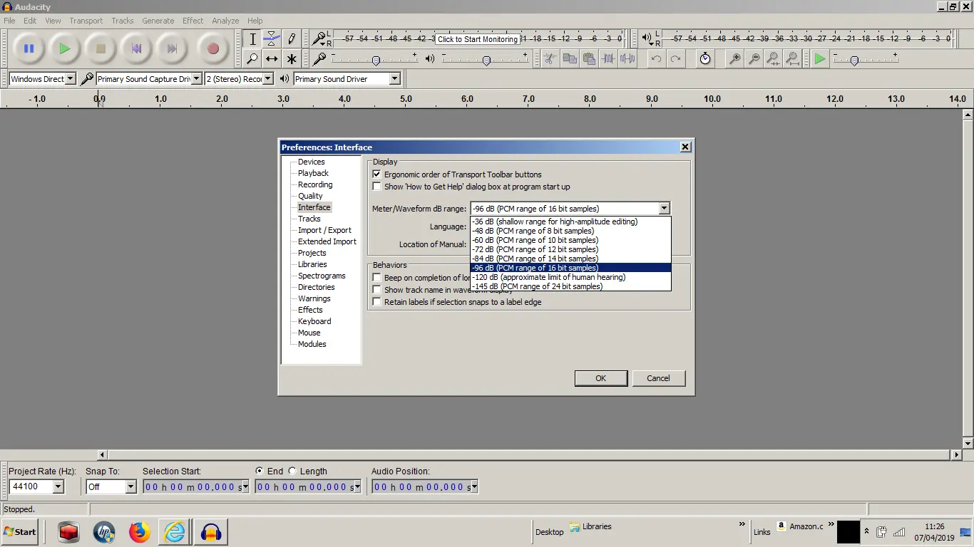

First off, have you found the setup screen attached? I have set mine, today to the 16 bit dynamic range and a quick test recording gave a noise floor of -64dBfs (some setting of the internal Ltop soundcard. Can do a more precise test if required) so clearly Audacity CAN get better than neg 57!
Audacity cannot run ASIO drivers so it is likely that Windows is setting the noise floor by setting far too high a gain in the recording path. Go into Win Sounds & Devices, find the Solo and set the gain (aka "level") to around 5%.
The basic test is to have nothing plugged in and the gains at minimum. Now record a 20 second clip at 24 bits/44.1kHz. If all is as is as it should be the noise floor will be close to -100dBfs.
Also try Reaper, that runs ASIO drivers.
