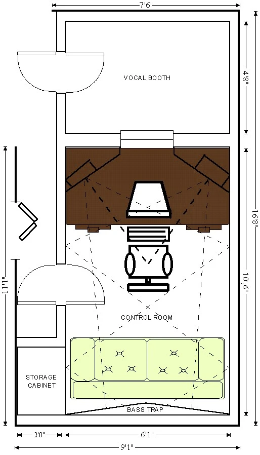

Here's what I did with SmartDraw. That's actually what I plan to build. The reflections are probably not perfect. And the design is probably not perfect. And I'm probably not perfect :D.
Anyway, give me your opinions.

What kinda stuff do you intend to record and mix in there?
If It's mainly vocal stuff, then it seems okay, maybe even an acoustic singer (if you know what i mean)
but you haven't given much space for a keyboard (basic necessity in any studio).
the shape of the control room looks good though, and you've dealt with most reflection pretty well.
good luck

One word: Rap
The computer monitor will be more against the wall and the synth (I'm dreaming about this Motif 6 :rolleyes: ) will be on the desk just in front of the monitor....
I will put 'resonator slats' (I think that's what you call them) on the walls of the control room to absorb high frequencies.
Anyone could think of something that would not work or everything seems ok?

Sounds like a good idea. You may want to consider a few shelves from a practical point of view. You'll need a sampler or two as well, maybe some turntables too?
I wonder if you would benefit from a foldable table in the side wall or something. When you weren't using any extra stuff, you could then fold up the table and put it in the closet!
Also, don't forget the ceiling. Studio's are 3 dimentional spaces. If you have a flat ceiling, then the reflections are in parallel with your floor.
Maybe a gentle sloping ceiling (about 12 degree's) might help, but i'd rather some people commented on that before you go off and do it!
Good luck

Should there be that sloppy ceiling in my vocal room too?

Yeah - I'm here :) looks good. Welcome to smartdraw :)

The rooms aren't built right now... It's just plan.
The room that will contain the rooms (;)) has a suspended ceiling.
