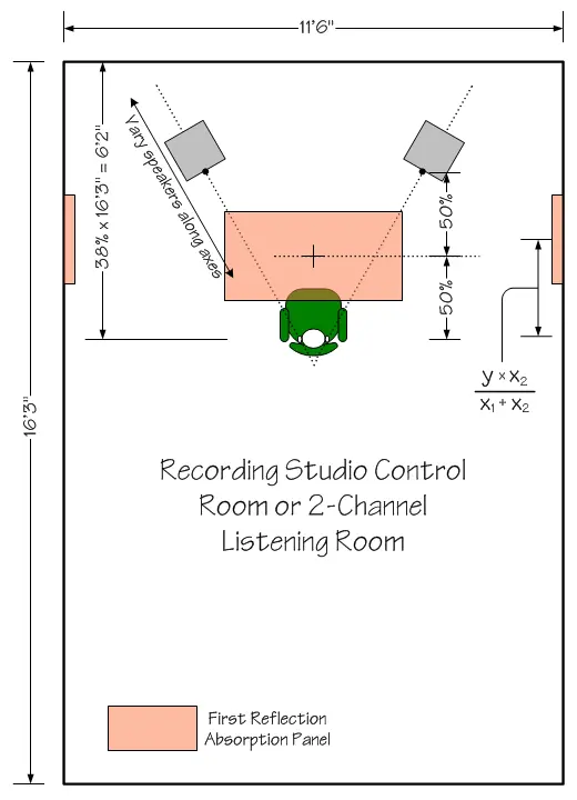

clap your hands in the room...if you can hear it echo, get going on some room treatment reading.
its a fun time driving yourself nuts!
this helps...read Ethan Winers starter sections and its not too deep.
