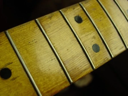

This pic comes from a '53 Strat. I can't assert that the frets have never had work on this guitar but, where they are not worn, they are like the frets on a new Fender were. I had to reduce the size of the pic to attach but I believe it is large enough to see what I'm talking about. In the unworn areas the frets are flat on top.

looks very similar to that,but if it is a new guitar should they look like that.Even though it is a "reliced" guitar I would think they would use new frets and not wear them down.
I don't believe your guitar is like that. I believe you have wider frets with a crown done as Muttley said "in the normal fashion". If your frets are very wide the crown will be a wider radius and your frets will look flatter than standard frets do.
If you want a definitive answer you'll have post pics.
