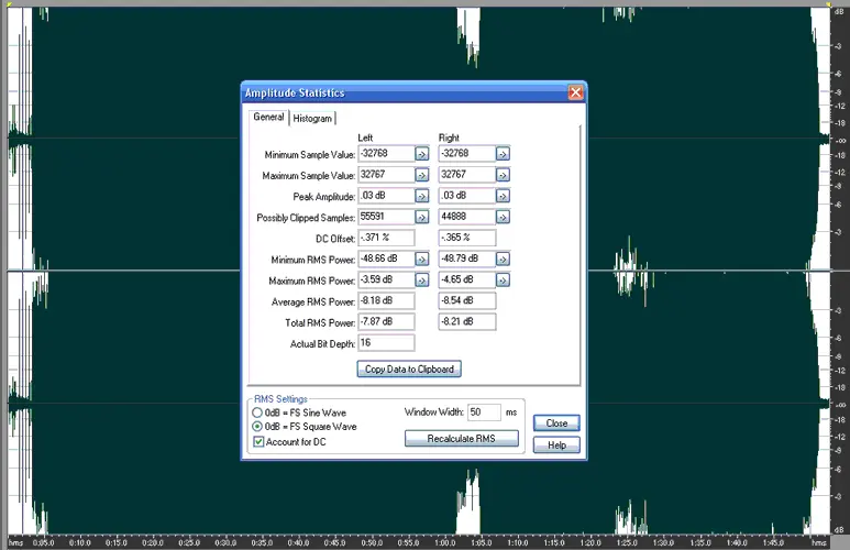

Yes I'd say it is compressed and limited - look at the image of the MP3 file in Sound Forge. :D
Sorry I can't upload the whole image - got to get me one of those editors - suggestions anyone?

The crackling is happening because you are using digital maximum for your limiting. :eek: See attached pic, the "possibly clipped samples" reading should be 0, you are in the many thousands. Every one of those is a click or pop, and are quite unpleasant, even for grindcore.
The roughly -8.3db average power and -4dB maximum power is exceedingly loud. Just about to the point of unbearable, especially with all the clipped samples.
If you only gave the drums compression, you gave a shit-ton of compression and limiting to the overall mix (during "mastering").
I think a better mix, that has been mixed down with no clipping... hell even give it 12-8dB of headroom. And put it in the hands of a decent proclaimed Mastering Engineer, it'll sound a lot better and a lot more professional.
If you insist on doing your own mastering, do research on the subject. It's a very important step that is often overlooked by home recordists.
