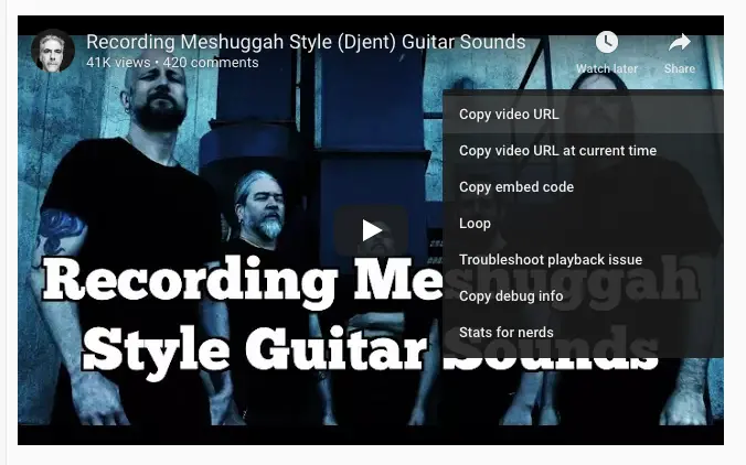

And, not sure this is relevant, because hi-gain can mean a lot of things, but this is a pretty simple setup with just a couple of "amps". (Really, I think what you describe would be a lot more manageable ITB, but it's your ears.)
YouTube

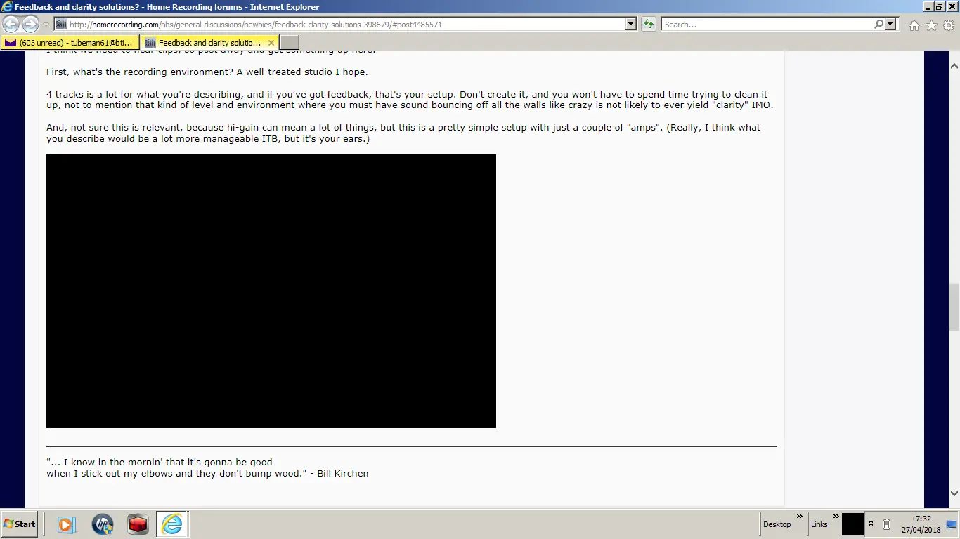

Just get a big black rectangle Keith. If I copy the url into EI11 I just get "site cannot be found".
No idea. Looks like this on my system (and the YT key/code is ZKIR2ncZlpk).
Attached is what I got (still there) .
I see the picture in the last post but all is 'dead' cannot play it. If I put the code into Google it finds it and Bazinga! I have da man!
