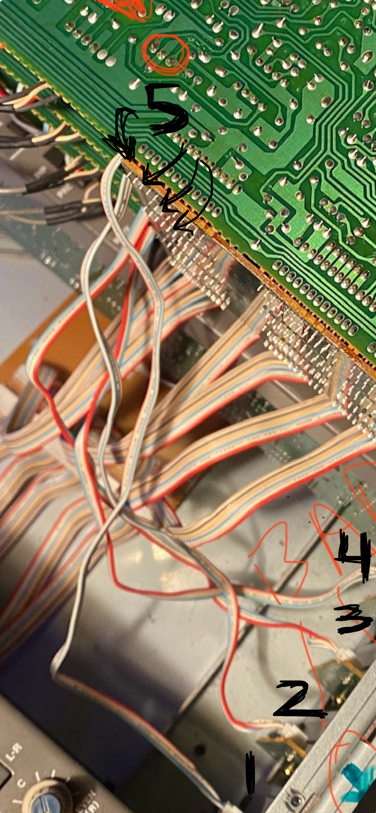

This confirms why the faders were doing nothing except “off” or “20db gain.” It’s mysterious how they ended up this way. The wires are permanently installed in their plugs backwards. Everything is fine until the wires go past the metal wall into the channel area. There, some are reversed inside the plastic plug.
Check it out in this photo.
#1-#4 are wires from 4 faders. You can see the permanent odd shaped plug for each set of wires. #1 has a blue wire on top, permanently mounted in its plastic plug, red on bottom. Yet #2, and #3 have a red wire on top, and the blue is on bottom. At #5, each fader wire bundle attaches to the channel. Here, on each and every channel the wires colors match. Possible a tech forgot to reverse some of the soldered in spots? At the hand unplug spot , those colors were definitely either reversed at the factory or it’s the wrong wire sets, maybe NOS. Hmm
