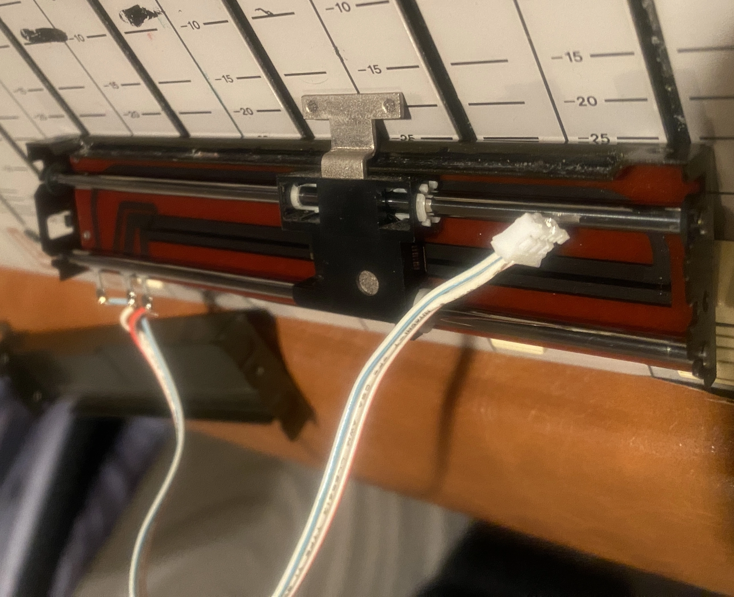

What kind of faders do you have? It sounds like you might have an issue where the wiper that progressively shunts signal to ground is not contacting. If you weren’t careful with your cleaning process you have have deflected a wiper set enough it no longer contacts the element…complete hypothesis.
These are those ALPS faders in a metal case. I’ll maybe post more details tonight after I get home and feed myself. I’d be surprised if I bent something. They seemed durable and I was being gentle. Thanks for the clue!
Putting a multimeter on it reveals that I do not know how to test a fader with a multimeter ?
I do see some fuzz caught under the wiper part that bridges the two carbon tracks. I’ll clean this out and try it again.

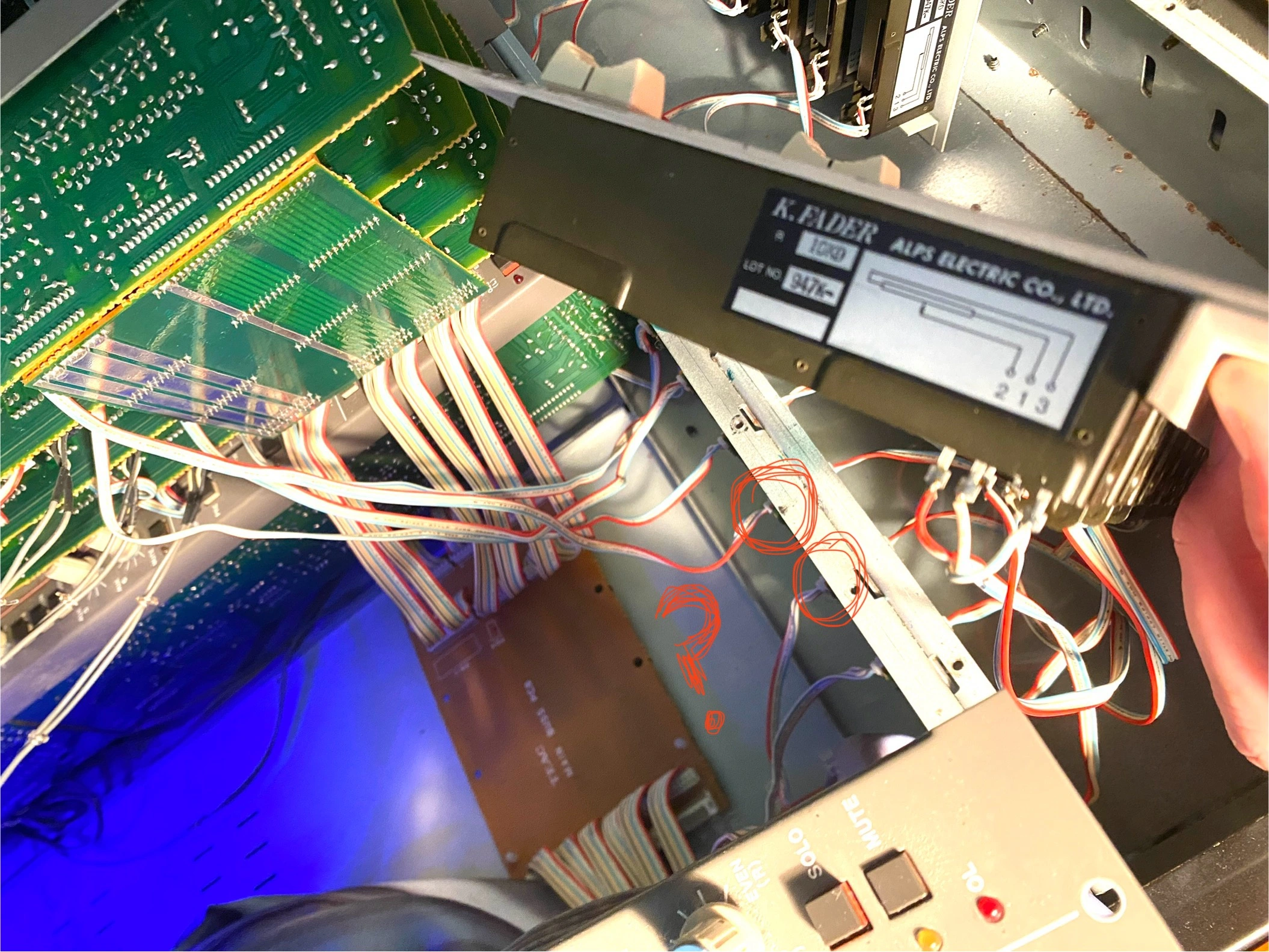

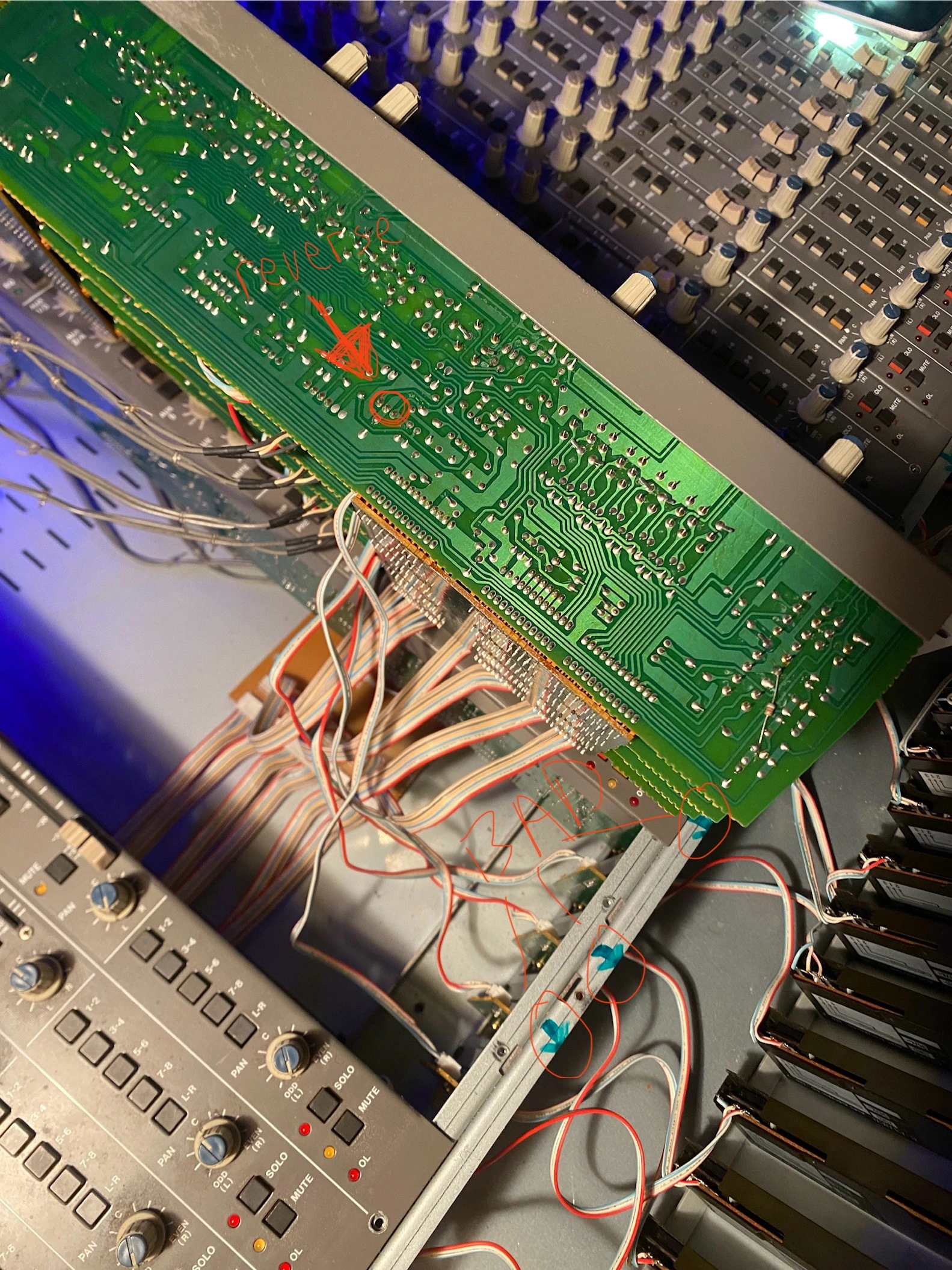

I pulled up each channel strip to inspect the solder joints connected to the other failing joints. I discovered that many of the wires were reversed during manufacturing.
From looking at the fader, is it ok to swap wires for 2 and 3? Like, can wire 2 go in 3’s spot on the fader? And vice versa? I’ll correct them all since I’ve got it apart but if it doesn’t matter then I’ll leave it alone.

I’d say leave it alone if it came like that from the factory. Keep in mind however they wired it up, it worked.
Your task is to restore it back to its original state of functionality.
Thanks for your input! I will leave it alone. My only concern that if the signal is balanced by the time it gets to the faders. Then I worry that inverts the phase. This happens on 10 out of 40 faders, so, I’ll assume the manufacturer was not as ignorant as I am, and the wiring is fine. Thanks y’alll!
