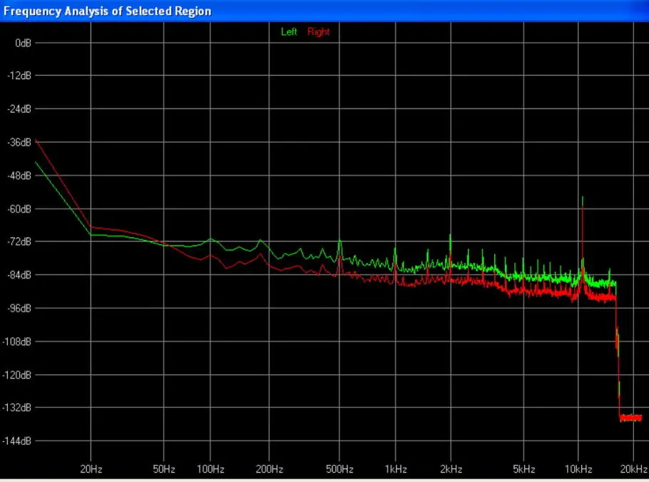

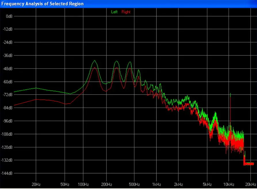

Here's the freq analysis of the sample unprocessed. You'll note a weird very narrow peak at around 11khz. The rad cut at about 17 would be the MP3 processsing that the file underwent before being sent to me.

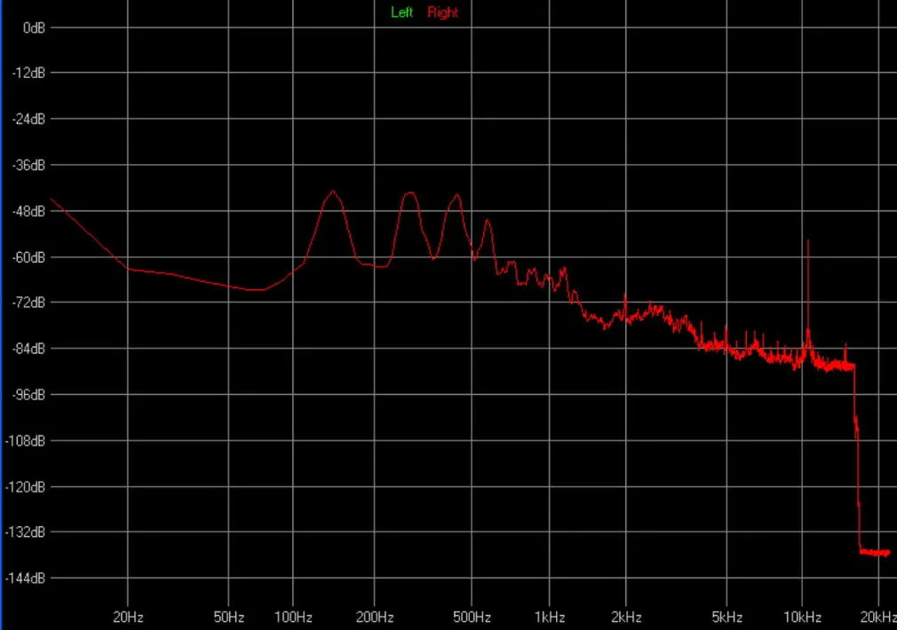

Now this is JUST THE NOISE as selected by the noise reduction process:
Whoops, sorry - just noise!

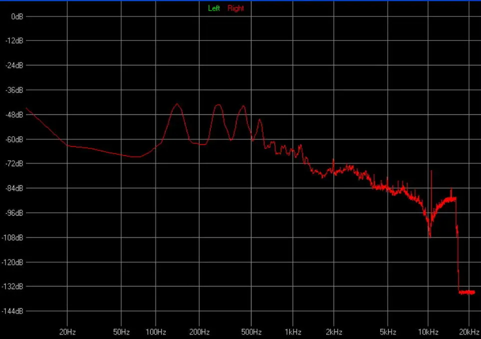

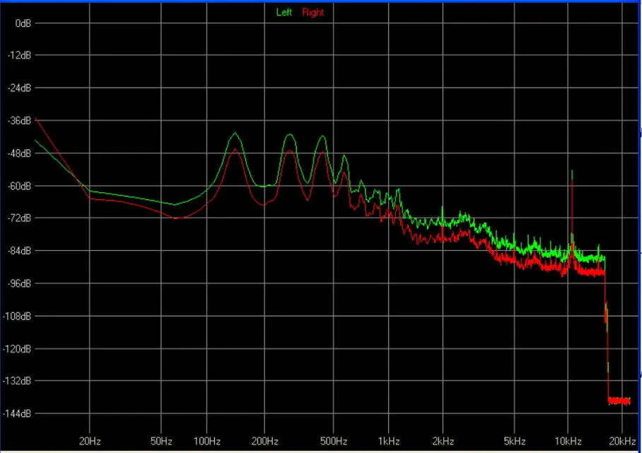

and finally the vocal sample after some basic noise reduction.
Now Terry has a very, very nice sennheiser mic (can't recall the model) into a little Behri mixer for preamping, into a stock generic computer sound card into audacity.
Any ideas?
Oh, & there's a DC offset problem too...I've managed to deal with that but it shouldn't be there.

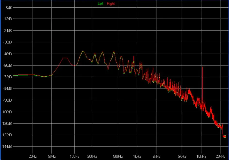

Here's the backing track WITHOUT the vocal:

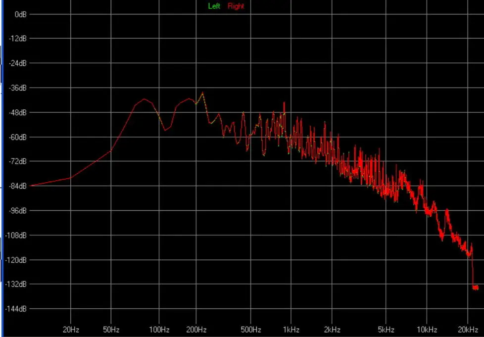

& the backing & vocal (post some vocal processing) combined:
Have you tried a huge cut with a high q where that spike is just above 10khz?
I wonder if the noise is computer/USB related. I found my old laptop with USB plugged in had a lot of underlying noise, although it was less discernable with music playing and running on batteries. It's reduced on my new laptop but if you wire it up a certain way you get some noise...and it's a high pitched noise too...
Does Terry have any noise coming through when he's not singing?
That's a good point. My laptop has a built in mic that if I don't mute it, gives off a very similar pitch... not the same thing as this, but maybe it's picking up fan noise or some other weird stuff is coming through the interface?

Two images 1st NO cut & then -24 and as on the spot as I can get with Q about 8 (I tried higher but the peak "seemed to "move" to the edge of the cut.
