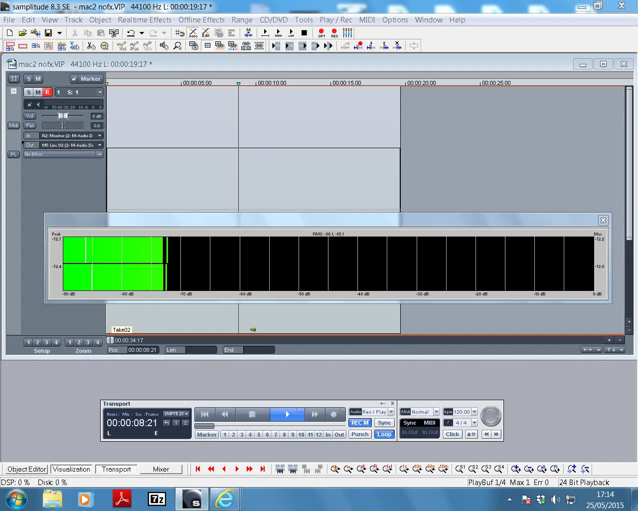

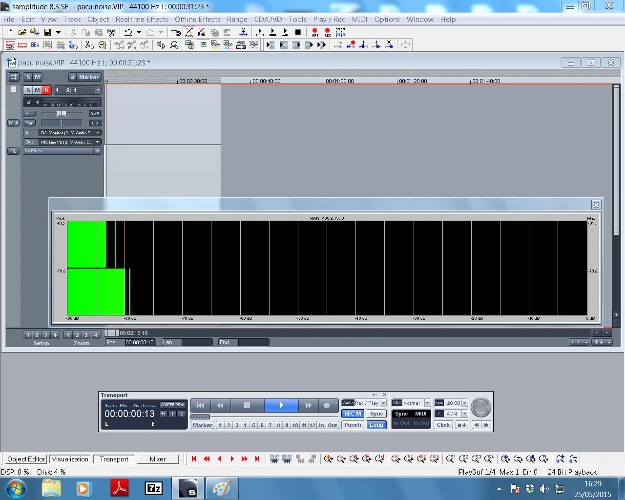

Take a look at the attachments. My baseline soundcard noise is around -83dBFS* but your clip is at only -63dB ( pk for both) . That frankly is little better than a top line cassette running Dolby B and is about 7dB worse than a 15ips Studer with Dolby A!
You could actually save hard drive space and record at 16bits because the system is barely 11.
I can if you like hook up my NI KA6 which I am confident will better both at some -100dB.
Harmonic distortion is beyond my means these days (I HAD access to an AP test set) but of course I would in any case need a recorded tone. You might be interested to record 1kHz at say -1dBFS and then run it thru a spectrum analyser and see where the sidebands come up to? But in truth, any capacitor mic buffer amp will produce more THD than almost any A-D/D-A converter in this context and your speakers a couple of orders more at 85dBSPL.
*That is at least 7dB worse than it should be. Just shows how things can get away from you if you don't keep up!

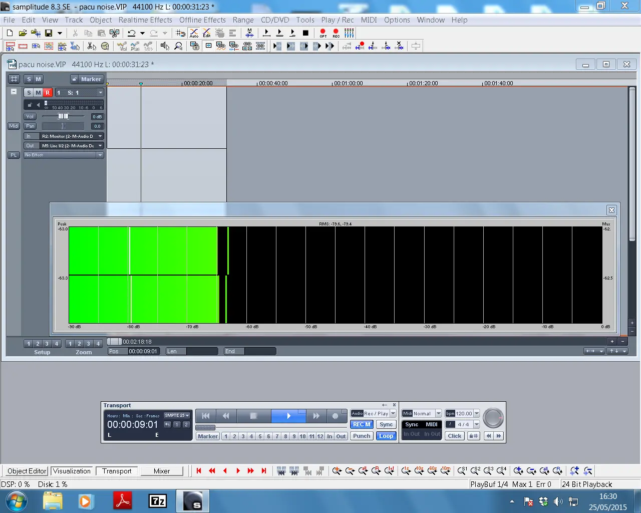

Hold on a second, that made me realize something. There are effects on those two tracks; one is male, the other female. The default. Let me run that again, if you will; I think that we are seeing the effects on the tracks.
I am thinking that the previous two tests were not testing the audio D/A in as much as they were revealing some shortcomings of Garageband 'll as a DAW. Though it works in 24 bit, I believe that the output is 16. Here is a capture run from another piece of software, which should be of higher resolution.

Okay this is interesting, I just recorded then analyzed it myself, and I get different results. Actually this time I had the mixing board on.
Sorry but they are spectrums I showed you the actual noise levels on the DAW meters.
I used the rather ancient Samplitude 8se because not only does it have a 90dB range but also a numerical readout in both rms and peak that goes below 90dB.
A much clearer spectrum can be obtained from the free program "Right Mark Analyser" I have to cook dinner soon but I shall come back in the morning with some fresh data.
Oh! Well I don't know quite 'where' it is being measured apart from in the file but it is my working understanding that this is a graph of dB and frequency, dB being amplitude, and I think that the blue area is basically where there's energy present at a given frequency with no actual wanted signal delivery, I don't know much about it but thought that this would be the 'noise floor of a given 'slice' of recorded bandwidth.
