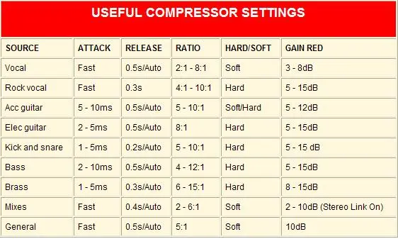

Those are pretty heavy settings, I would never use 8:1 on any electric guitar. Hell, most distorted guitars don't even need compression.
And yes that was sarcasm before :)
