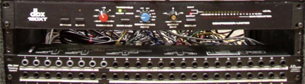

A patch bay is simply a clearing house for all your rack gear, you run your ins and outs through there to alleviate the need for crawling around behind your stuff to plug it into your signal chain. At your point, with one or two pieces it is not necessary
Here's a quick snippet of my mobile rack with the patchbay.
See all the cables in back? Then all the jacks on the front of the patchbay at the bottom?
I have a bunch of short cables (patch cables) and I can create any chain of all the gear in the rack by popping a few cables into the patchbay. Not in the picture is another bay just below- that goes to all the insert jacks on my mixer. So right there at the bottom of the rack I can route any combination of gear in any order to any track on my mixer.
Beats crawling around behind it messing with long, tangled cables.
More useful for analog mixing, but can come in handy if you're using good analog gear to record into a DAW. I lived for years without a patchbay until I switched to mixing on the analog board. Now I can't live without it.
