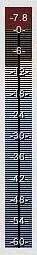

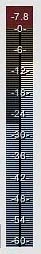

Some graphics - before and after switching in the unit on the left channel:
