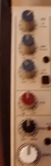

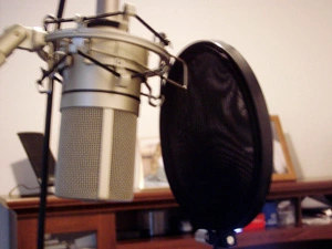

Hello, I am having alot of problems with EQ. Im not good at it at all. I read a post on it once saying to leave your mixer EQ levels just in the middle but I cant becuase then it sounds sooo muddy n not clear...i have a middle tone to a little higher pitched voice....i use adobe audition 1.5 n i have WAVES plugins if any of them deal with EQ maybe....I have a pic of my mic setup...I have it pointing a bit downwards cuse i heard thats better to do......The one pic is a closeup of my EQ levels n the other is far away with also the FX send levels which i keep in the middle....and the last pic is of my main mix slider.....
ANY HELP WOULD BE GREATLY ACCEPTED PLEASE...im so stuck on this EQ thing n its making my mixes not sound very good

Have you tried singing through the other side of your mic? Even with a middle tone to a little higher pitched voice you should track with using as little to no eq and effects.

Muddy sound,voice is related to lack of ,the mid- and high range eq.,,back set up of compression,etc. you should try to set eq. with a CD,or other source,untill you could hear everything crispy,clear,and them try the voice.
