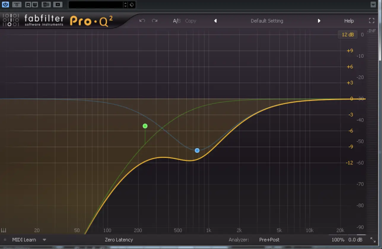

I am mixing vocal and guitar. I used EQ and comp for guitar and EQ and reverb for vocal. Settings as well as dry and wet samples you could find in the attachments and by links. I had to reduce guitar lower than 1kHz by 10 dB and more. That looks strangely for me but otherwise there were too much "noise" in sound.

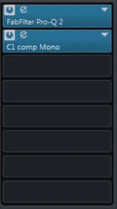

Guitar effects: View attachment 110939
Guitar EQ settings: View attachment 110942

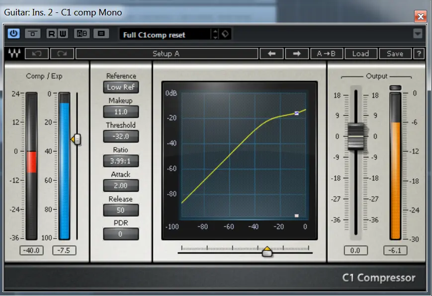

Guitar comp settings: View attachment 110933

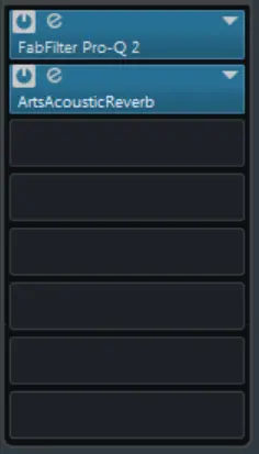

Vocal effects: View attachment 110951

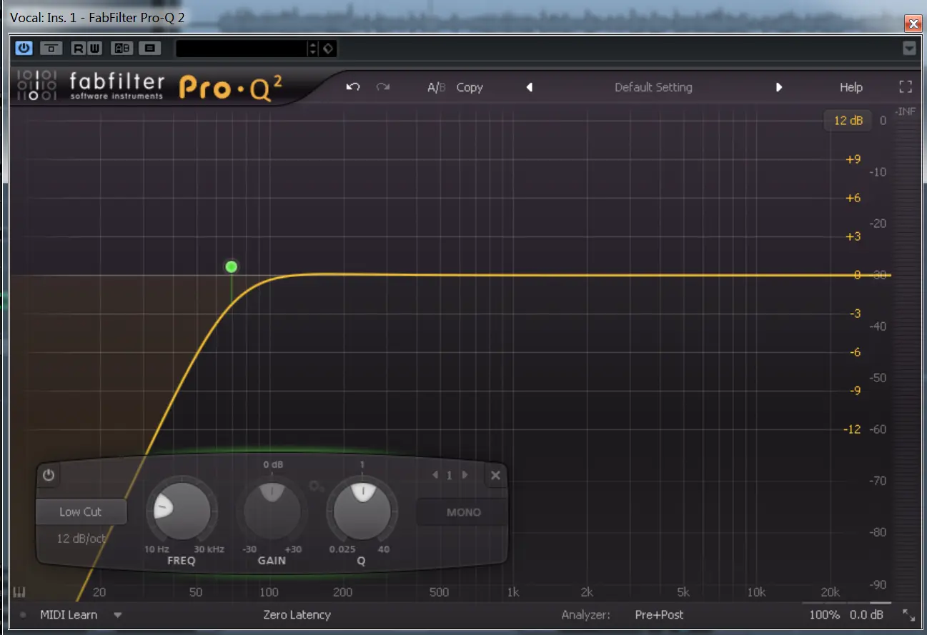

Vocal EQ settings: View attachment 110954

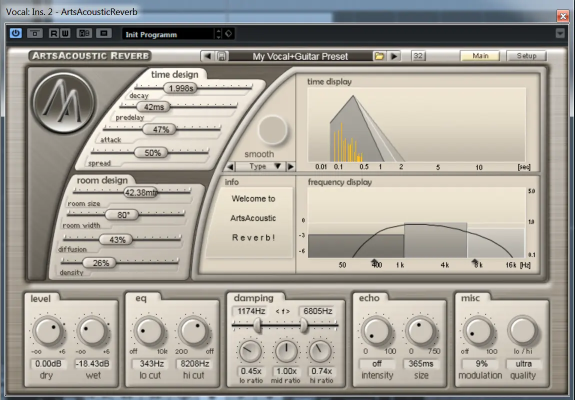

Vocal reverb settings: View attachment 110957

guitar overdone with EQ. instead of the massive cuts below 1khz. try to retain the warm by being more selective with your EQ, You probably need a little cut around 350hz just to tame back that lil bit of muddy indistinct sound. then scoop around 800 hz while your vocal is playing and is balanced until they play nice together. High pass as minimal as you can if it is only just a vocal/guitar track. so High pass at 80hz ish. Set a low shelf filter at 220hz (this is a standard EQ setting for some consoles) and pull it back intil the low end sounds right. if the high end becomes too much on the guitar, set up a de-esser at 4khz+ to pull it back when it becomes harsh.
I'd probably heavily compress the guitar but mix in 20-30% wet just to fill in some of the holes

I do agree the guitar sounds over EQ'd. One problem you may have with guitar and your voice is the significant overlap in frequency range, so I'd expect some cuts in the area of your voice, but what I heard sounded a bit drastic. Maybe if there are more instruments in the mix that I don't know about, like bass, keyboard, drums, etc. that also have LF content and there it is not unusual for the EQ'd guitar to sound pretty thin, when listening to it on its own. But, again, what's your total mix supposed to be?
I believe many (maybe most) of us do not put reverb on a single track, but set up a separate bus with reverb FX and use a SEND to blend in reverb on individual tracks. Again, the amount of send is determined in the context of the mix, and not usually by listening to an individual track. Now, if you want a specific reverb type, like spring on the guitar, plate on the vocal, you might put those on the track, or you might still create a separate bus/send just for a single track, depending on your DAW and workflow, but even then, I'd listen to the individual track only to get a sense of whether that specific verb was the sound I wanted. The amount/wetness is a mix decision.
