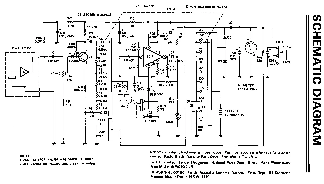

Replace the mic on this schematic with the WM61b along with changing the following:
C1, C2 from 1uF to 10uF
C3, C4 from 1uF to 47uF
C7 from 10uF to 220uF
C8 from 100uF to 470uF
C9 from 22uF to 220uF
C12 from 33pF to 12pF
C15 from 100uf to 220uF
This mod is taken from http://www.gti.net/wallin/audio/rsmeter/33-2050/33-2050.html

Swapmaster said:
Ok, I did a compare between a stock WM61b and one with the Linkwitz mod and the modded one is about 13db down from the stock WM61b. Which puts it about 6db down from an unmodified WM60ay. Does this sound about right?
This is entirely possible. The transconductance spread on FET's is notoriously wide and the sensitivity in the common source (as shipped) configuration is entirely dependant on that transconductance.
Going to the source follower via the Linkwitz mod, the gain from the gate is pretty close to one. The sensitivity in this configuration, while lower, is likely to be much more consistent from capsule to capsule because the diaphragm/gap/backplate geometry that determines the sensitivity measured at the gate is much more controlled than the transconductance of an FET.
Bob
Take away resistor R26, replace C15 with highest possible value----thousands uf would be fine. Connect Drain of modded capsule to R15--C15 junction. Source to C1 with 10K resistor to ground, and ground the capsule.
Marik
About the mod you suggest to my meter preamp. What will it do?
I do not understand what the drain or the source are. I assume the drain is the positive and the source is the negative connection from the capsule.
Do you mean to connect modded capsule drain to C15/R25 junction? You stated connection to C15/R15 junction which does not exist.
This is what I understand so far but it's probably wrong
1. Remove R26
2. Increase C15
3. Cut ground from FET on a new capsule, connect factory capsule - to C15/R25 junction
3. Connect factory capsule + to C1 positive side
4. Connect 10k from C1 positive side to ground
5. ground capsule case.
Will this change the gain settings for VR1 ? I need to keep it to adjust calibration.
<I do not understand what the drain or the source are. I assume the drain is the positive and the source is the negative connection from the capsule. Do you mean to connect modded capsule drain to C15/R25 junction? You stated connection to C15/R15 junction which does not exist.>
OK,
The drain is unmodified pin of the capsule. Connect it to positive of C15 (where it is connected to R25). The pin which you just cut from the capsule case is a source--connect it to positive of C1, and from this connection run 10K resistor to the ground. Ground the capsule case. It is the correct way of connection. On the second thought, you cannot connect the capsule through RCA connector, as you need to do it with THREE wires, so it might be a better idea to use existing XLR, and modify connector on RS. This might be the case why you loose 5db of sensitivity.
If something is unclear feel free to contact me.
Let me know (or post on the board for everybody's benefit) how it came out.
Best, Marik
Ok, I will try the mod this weekend and see what happens. There is no room for an XLR plug on the meter so I will use 1/8" sterio plugs.
Thanks
One last thought before I do the mod. Is this still considered a Linkwitz mod? Do we want to reverse the fet connection to the board as the Linkwitz does or is cutting the ground from the FET is all we are after?
Ok, I just looked at the sketches on Linkwitz's site and you are using the source follower 3 wire hook up. I understand now.

The way you use it, you cannot make two-wire connection, because it requires opposite polarity of battery from what you get in your RS meter.

I found my db problem. With the Linkwitz 2 wire mod I had terminals 1 and 3 going to ground and terminal 2 going to C1/R26 junction. I reversed connection on the capsule and it is just a few db down from the stock WM61b. Will your suggested mod be of any benifit or should I leave well enough alone. I am happy with it now.
Swapmaster,
As I wrote before, the resistor R26 should be taken away. I never tried 2 wire connection before, but in this configuration the battery polarity should be reversed and actually, I don't really understand how did you connect it now. I would suggest you to connect the way I did, as I know for sure this way it works right.
After the Linkwitz mod I connected the pin that I soldered the capsule to C1/R26 junction and the pin that was detetched from the capsule to ground. It is connected the way Linkwitz shows it as a source follower 2 wire connection. The db's are down just a few from the factory RS capsule so VR1 allows me to recalibrate it easily.
